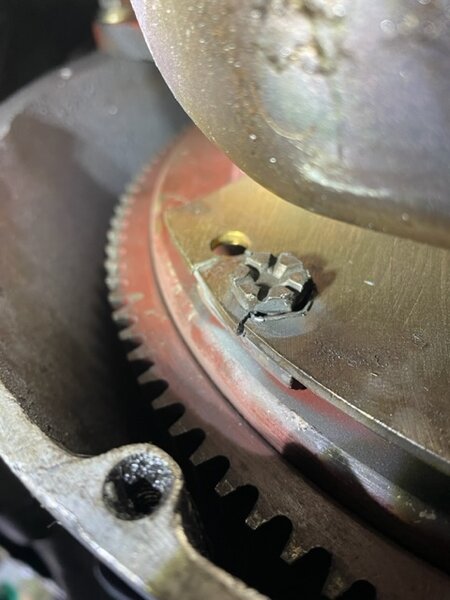

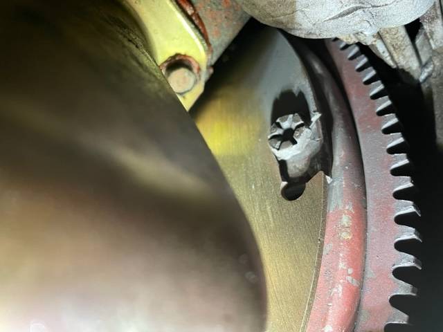

Found the culprit. After being away for quite some time, I finally got around to jacking up the car to pull the trans and noticed right away what this issue is. All but one bolt has this damage to the flex plate. Any ideas what could cause this?
Yep, that flex plate has the option for two different bolt sizes. I think you put the small bolts in the big holes and it hammered the hole out.

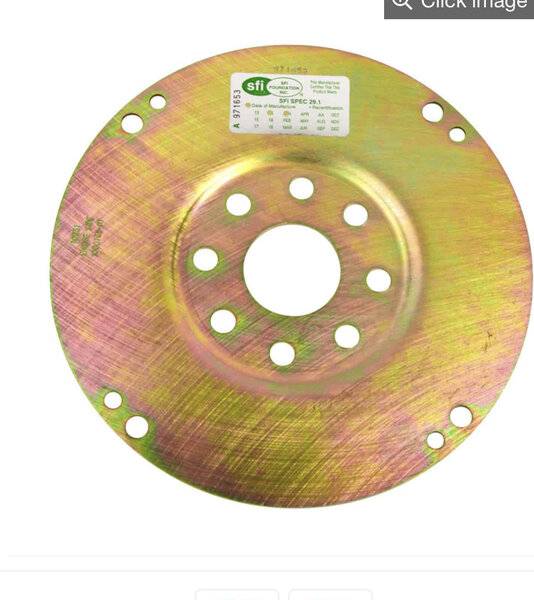

This is it. Well, yours has the cutout I think for it he correct balance. Both have the two bolt size options.
Also, going to get a new bolt kit. Would you happen to know if there is a bolt kit specifically for this application? LA 360 to a A904.
There are two bolt sizes, not really an engine/trans thing. More a what converter it is. Mine are aftermarket converters so they are the big bolts. I can’t remember what they are, however. I just converted from a 727 to a 904 and I know the flex plate is different. Make absolutely sure you get a 904 flex plate, not just a small block one.
yeah 10239 seems like the la to 904 external bal flex plate. You
