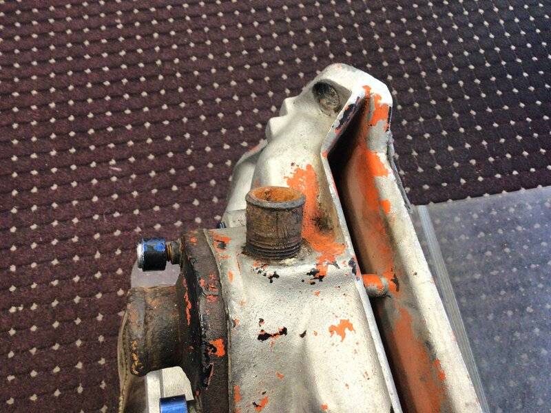

Whats the best way to get this fitting off
B3422w5
Feb 9, 2017
3,854
4,930
Portage michigan
Without breaking my intake.
Been on there a minute, looks like

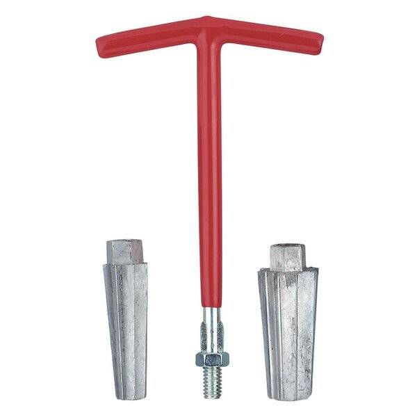

THEY MAKE A INTERNAL PIPE WENCH THAT GRIPS INSIDE, HEAT HELPS
