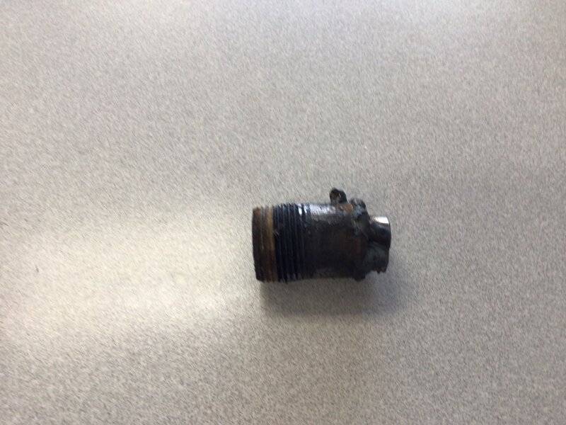

I had to add additional heat after I welded it. The first 2 attempts broke the weld on the 3rd attempt I welded it and the put a torch around the fitting.And the heat from the welding helps the process.
A tip from Detroit Diesel to get those pipe plugs out of iron, heat the plug and melt canning wax around the thread while hot. Let it cool, The heating expands the cast iron slightly and shrinks the plug. As it cools, some wax is drawn in to lubricate the threads. Should work for this.I had to take an open hack saw blade and carefully cut a slit in the pipe. When it gets really close to getting all the way through, you can squish it with a pair of pliers and it will come out easily. Oh yeah, penetrating oil doesn't hurt.
You can speed up the process by using a cut off wheel or saws all for the portion of fitting that sticks out of the manifold.
Great idea using a internal dowl or socket for extracting, but I would use penetrating oil while taping fitting lightly in order to loosen threads a little and allowing the oil to do its work before trying to remove. This would be my first approach before attempting other methods listed above. Would like to add, if using heat, I would heat the fitting and not the aluminum intake, because the steel fitting would expand slower than the intake expansion. The heat would transfer to the intake without damage.I clean out the inside of the fitting of as much corrosion as possible with a Dremel wire brush, soak in penetrating oil, then use an inside and outside pipe wrench together if it's a stubborn one. Cut and crush as a last resort. I don't like to put a torch on aluminum, but, I necessary keep it to just a propane one. Use some good pipe dope like Never-Seize on the new fitting so you never have to resort to this again.

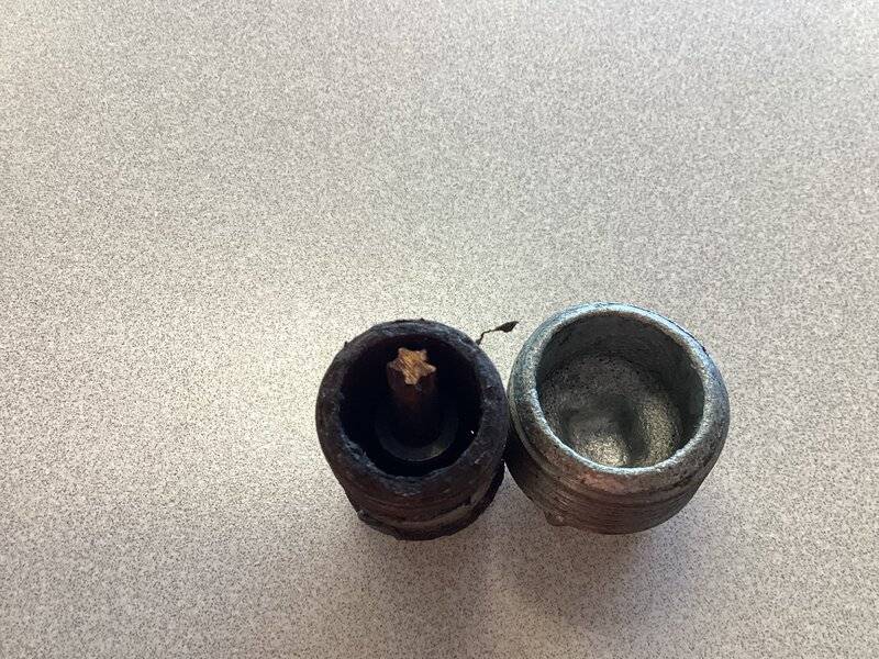

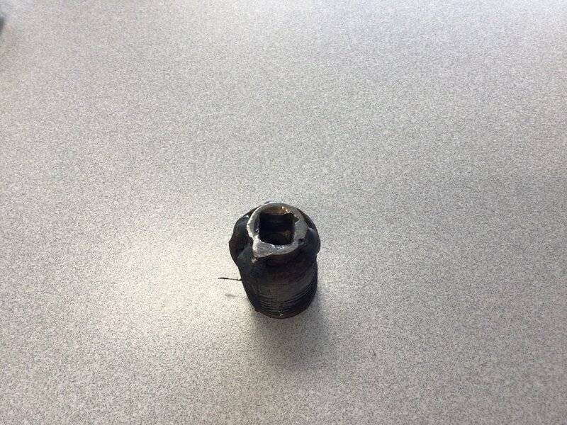

I used a old rusty impact socket that I had to grind slightly to fit hammer tap in tight inside and welded it on. Then while still hot PB Bustered the crap out of it for two days. Clamped the manifold in the 20 ton shop press and used an 1/2 impact on low and hammered on it for a bit both loosen and tightening. Did not hurry.
Cut it pie shaped and bend the "slices" in. Soak it with a mix of acetone/trans fluid.
You guys beat me to it. I cut mine into two pieces with a loose hack saw blade, being very careful not to cut too deep. Then I tapped the top towards the cents like Steve said, added some penetrant, let soak for a while, more tapping, more penetrant... It took about an hour. The treads were fine.I had to take an open hack saw blade and carefully cut a slit in the pipe. When it gets really close to getting all the way through, you can squish it with a pair of pliers and it will come out easily. Oh yeah, penetrating oil doesn't hurt.
Genius.Got it out.
Welded socket to inside of the fitting, hit it with impact, came right out.
