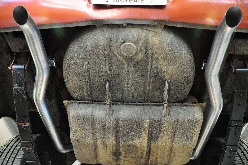

Pics of the Accurate tailpipes we reused with the new system. Maybe I'll fix it this year.
Backstory.
Atmospheric pressure at the tailpipe is 14.7 psi against the pressure flowing out. The further up the system that 14.7 psi gets, the more it will slow down the flow out the exhaust ports of the engine. Keeping the velocity up near the exhaust ports will reduce reversion on any engine, but especially an engine that spends more time at low to mid rpm, or has to spin through low to get to high rpm.
Stepping up through the primary tubes is usually a good technique to keep the velocity up and yet not restrict higher rpm flow. Pipe-max shows H- Pipe or any other major change should be about 20" after the primary tubes join for most of our engines. By the time the exhaust is at the mufflers its cooling and the mufflers cool it much more. Mass of the exhaust gas stays the same but the volume is less.

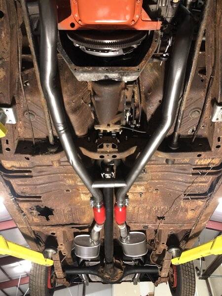

I used the 62-74 2.5" B body tailpipes on my '70 Roadrunner. They are good quality and fit was good. I bought them about 5 years ago when the price was somewhere between $100-130. The factory H pipe was still good, so I cobbled together pieces to go in between from an S bend kit I bought 15 years ago and still had pieces left. That kit has also gone way up in price. It took me about 3-4 hours to put it together.
https://www.flowmastermufflers.com/...onents/j-bends_u-bends_and_tubing/parts/15926
At todays prices, It might be better to get a whole kit. But I probably have under $250 in this full exhaust.

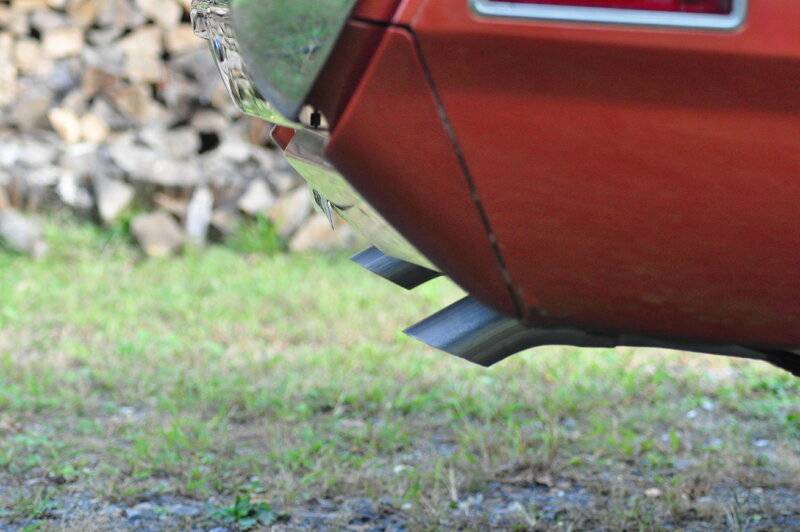

Note: I added the turndowns by cutting a couple of the S bends from my spares. And I didn't need a pipe expander for anything on this exhaust, the S bends come with one end expanded for slip fit.
i went tti. fits awesome.. ther is some trimming needed to get it to fit properly. since its made for 67-up darts the tail piper stuck out way to far for me and looked stupid so i cut the turn downs off and slid them back some...
