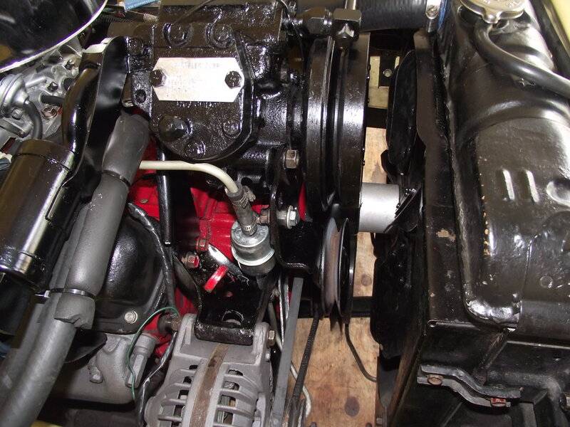

I had a parts car with a 273, AC and no power steering- perfect.
It had a shroud, a seven blade fan with a clutch.
Only one I’ve ever seen.
I haven’t gotten it on my car yet.
