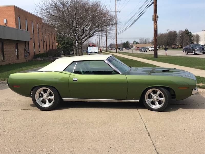

I've got a couple thousand, trouble-free miles on mine. It has all the gen-3 components and a HotWire harness. Lots of work, but behaves like a ScatPak 392 car.....only lots lighter. It also doesn't try to control my driving. I couldn't be more pleased.
