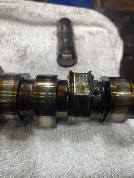

I’ve always had good success with HR cams. That said, there is nothing better than a hard roller. And if your geometry is right, lash is a once a year deal on a street/strip type car. Funny I saw this thread today, as I just pulled a custom ground HR out of my daily. Who said they don’t like to bounce? Ding ding ding give that guy a cookie.

I said nothing about the frequency of CHECKING lash. My point was lash adjustment, when the valvetrain is happy and geometry is correct, is not as frequent as people seem to think. And the failure above was caused by a broken valve spring on a cam/valvetrain that has over 300,000 miles on it.
