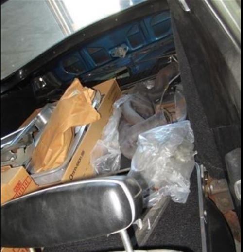

Grilles and trim rings are in boxes (unless those are extras behind the seats

Those look like they could be the original exhaust manifolds in picture #6 in the very right corner !! Research the 68 383 exhaust manifold numbers.

Carpet on rear interior compartment panels means it was probably a deluxe interior car with woodgrain inserts in door panels. IIRC, pedel dress up stainless was part of deluxe interior.
Are those and extra set of rear trunk trim moldings in the rear storage area?

Good eye. I did not notice the manifolds. If they are correct, that helps.
Exhaust manifold casting numbers - 2946729 passenger's side and 2863900 for driver's
Intake Casting number - 2806301
Carb - #4426 or 4426S Carter AVS
Heads castings - 2843906
