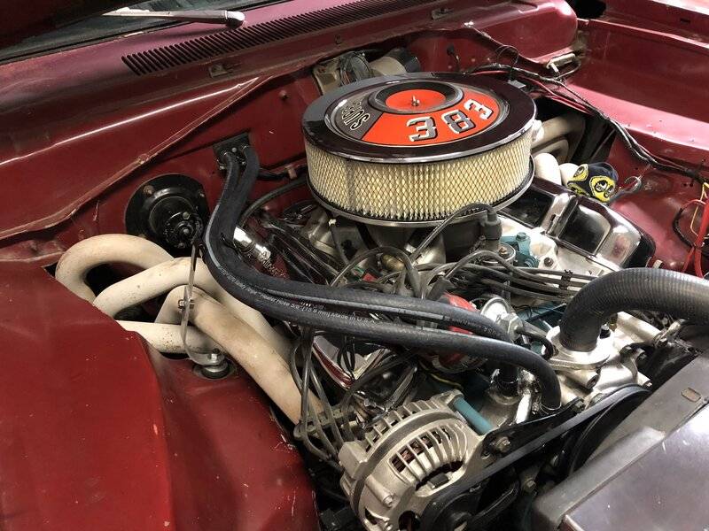

So I spent a lot of time just staring at the car's 383 with nice chrome valve covers and chrome headers. I think they are TTI's but I don't know for sure. I knew the mopar GIANT OEM starter was buried behind the driver's side header but I knew the starter wasn't going to fix itself so I started on this "repair."
So how many of you guys have replaced a OEM starter on an A-body Mopar with a factory 383 and long-tube headers? I've installed a number of starters on old cars in my 66 years, however, I've never done THIS particular car and starter. If I told you I'm ready to put a cube of C4 plastic explosive under this car, get a safe distance away, and then press the detonator button - would that surprise you? If you've done this repair, my idea shouldn't surprise you.
So far, I've removed the left front wheel; disconnected the exhaust from the header collector; removed all the header head bolts; removed two spark plugs; removed the driver's side front wheel tie-rod link; and the Pitman Arm hex nut. Tomorrow I'm on a search for a Pitman Arm puller tool. As all you guys who are now laughing your asses off at my "adventure", you already know that a set of long-tube headers just BARELY fit on a 383 in a 69 Barracuda. I have cranked the steering drag link clear over to the right and the Pitman Arm is still blocking the header so i'm going to remove that arm tomorrow and push the drag link out of the way. I'm HOPING that this will give me enough clearance to either push this header up past the starter or pull it down out of the car. I do have the car up in the air on multiple jackstands about two feet so I think I can get the header down out of the car if I can get it to clear "everything."
Soooo... do any of you guys have any "tips" or suggestions on a better way of changing a starter on this car? Am I making any big mistakes when there is a better way to do this repair? I really don't want to disconnect the motor mounts and try jacking the engine up or over to the passenger side for more fender well clearance. That is going to be my LAST option if at all possible!
PLEASE share any experience you may have with this repair and any tips you learned. Here is a picture of what I started with. The garage all around the car now looks like a bomb went off with all kinds of tools and antifreeze on the floor.

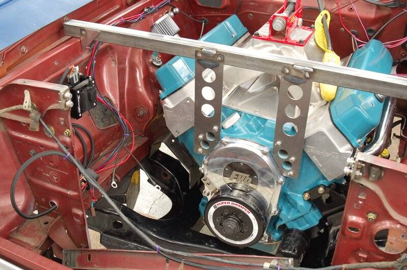

Yeah the K frame probably has to come out on that car to change the starter. That is what I do with my Duster. Once you have the correct tools it doesn't take that long to drop the K frame. You should do some planning rather than just tear into it. If you do it correctly you only have to take a few things apart. I built a fixture for my transmission jack so I can drop the K frame along with most of the suspension at the same time. Good luck with your adventure.
I use this fixture to hold the engine in place while the K frame comes out.

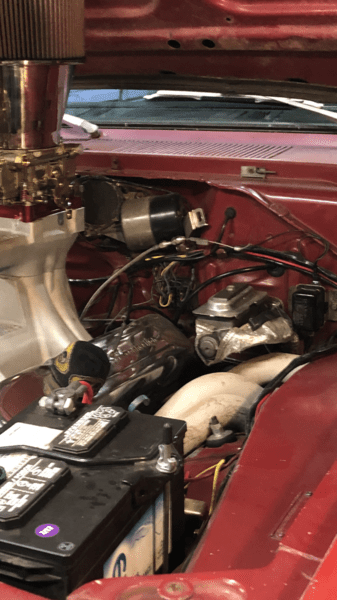

I went thru all that mess & decided if I’m going to keep the car & maintain it, I’m not going thru all that trouble just for a starter because no telling when/where one will go out. My 67 383 Formula S has a vintage set of NOS Hooker 1 7/8” Fenderwell headers with an old 70’s white textured aluma-coating. While most cringe, I have only found 1 negative(cut fender wells but I kept the sheet metal I removed), I have found plenty of positives:
1-Super open/easy starter access
2-Cooler engine bay temps with opened inner fenders
3-header removal without disassembling anything.
4-open/unobstructed spark plug access
5-transmission clear/open around shifter linkage
6-larger tubes/collector
7-looks cool, plenty of people see them say they never have seen this set-up
I had a set of those in the 80's. Never again. Tires rubbed (even small 195/70R14), low ground clearance at the flanges, hot on the feet...
Edited to add: really close to the master cylinder. I tried it on a 440 and had to make a relocating plate. Body clearance even worse with the RB.
I have mine sitting a little higher than stock height so I don’t have the ground clearance to flange issue or tire rubbing. I used a DEI starter heat shield under the master to protect from heat. I’ve got about 4 years/20,000 miles on this set-up so far & it’s worked well for my application.
