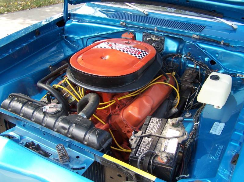

I had 2" CPPA under chassis headers in my 69 383-S for nearly 25 years. I was the 11th person in the country to buy them as told by Roland Osborne. Fortunately, I never had a starter go out, but everytime I pulled the engine during that time, I replaced the starter to try to eliminate the pain if the starter went out. There is no way that I could see to pull the starter without pulling the engine, however, pulling the k frame out from under the engine might work. I never considered that... Rod
