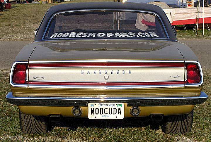

68 to 69 trunk and tail light transformation complete. It took some patience moving the filler piece mounting holes in the Laysons buckets. Dremel with a drill did the trick. The left fender hole opening needed some opening towards the center of car, a little odd since there's no sign the car was hit. The left factory buckets mounting studs were bent in a little to accommodate the issue.
Finishing plans are: polish outer trim of trunk panel. further fitment. redo the red lens color on trunk trim. Argent or silver paint on the center section of the trunk trim panel and lens filler sections. The enclosed pic is what inspired this transformation

That wasn't me, I don't know who the owner of that Cuda is, the picture is what inspired me to switch my trunk and tail lights from 68 to 69
