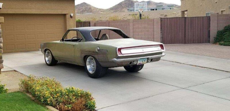

After a 6 month hiatus, I'm close to rolling again. Got a 20 gallon Stark tank on Amazon in Jan. for $175. Ram Jet speed shops selling this exact tank for $484. Plastic Center fill cap and sender are junk. Found a sturdy adjustable ohm correct sender and fabbed that in as well as a center cap. My buddy Austin welded in a barbed 2" nipple, its set towards the rear to avoid the trunk hinge. pressure tested tank. I really wanted to retain the flip flop cap inlet, you can see there's not much slope to tank, got a check valve in there down stream ( lone single hose clamp) fingers crossed. Trunk floor necessitated some spacing on the front mounts that are in that valley, rear mounts set flush to trunk and welded in. Got a layer of coroplast between the tank and trunk floor. Reworked the strobe mock up on C pillar. I also installed the windshield with a new gasket. First ever windshield install and against what ive read I did it by myself, not a big deal.

Just curious why you didn’t cut the trunk floor and drop the bottom of the cell down to the bottom of the spare tire well?
i wondered that, it obviously won't have a spare in there. plus the filler 'nipple' could've been right at the top of the tank side then too, it looks like you won't be able to completely fill the tank as it is.
also i'm sure someone would love to have that nice spare wheel well and you could've welded in a recess to properly fit the new tank while also keeping some useable trunk space.
You're going to laugh. I like the look of the car from the rear with a full view of the diff, tires etc. Anything hanging down was in the way.

Yep, there's a 100 ideas that ran through my head. The main goal at this point in time is to get it back on the road so I can continue to work any bugs out. I don't plan on long cruises so a spare and trunk space is not a priority, at least now. If it becomes a priority in the future, I'll make changes.

Well, that’s a valid reason. That said, I think I personally would’ve still dropped it down as low as possible without hanging out under the rear bumper. Even 2-3” would’ve helped with the filler tube having more slope.
Well, I think maybe I got lucky maybe not. The check valve, at least when filling from a gas can, is a liability in a tube with an angle this shallow. The tube fills up, overflows and you can hear it just trickling past the check valve into the tank. Removed check valve, problem solved, seems to be plenty of slope for side filling ,maybe a ride in the a.m. gettin warm here in Phx.
enough slope to side fill, also not enough to stop fuel running out on right hand bends unless the cap is a sealed one (not a breather cap). i totally get the rear view, but the spare tyre well's still there so having the tank no lower than that would be no different. i really think the filler tube angle will cause issues cornering, but you knew that already as you'd fitted the check valve. and as i said before you can't fully fill the tank as it is. your car, your call.
I had to ditch the check valve to gravity fill from a gas can. I can't imagine filling at the pump would improve opening the check valve, maybe. Anyway, I'm not that familiar with the factory flip flip cap but it is spring loaded and venting occurs down stream from the cap. Im certain I'll find out what the slosh factor is soon in right hand turns.
You make a decent right turn with that tank like that and check valve out, and fuel is gonna spray out from under that fuel cap
Thanks Matt, as it turns out fuel flow in at the pump is a pain even with the check valve out so I used the tank top cap, I'll put the check valve back in tomorrow. Sure was fun to have it on the road for a bit this morning.
Had time for a burn around the block, all systems go and this little 340 hauls ***! Too much fun right now to think about body and paint.
