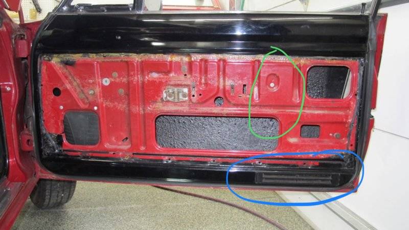

When the "domestic dispute" damage was repaired by Norm VerHage, he put on a 1967 passenger door instead of a '69. It fits OK but there are several visible differences:
1. The door lock knob is at the back of the door instead of closer to the front
2. There is a ventilation flap at the bottom rear of the door and another on the front
3. The latch and lock mechanisms are completely different than the '69
4. The vent window handle is different
5. The vent window frame has some small differences
6. The inner door skin is a completely different stamping
7. The outer skin is also a different stamping at the tab for the vent window frame
The door is in good condition, so I'm going to rework it to look like a '69 Door. ie move the door lock hole and weld up the old hole. Weld the ventilation holes. Change the latch and lock mechanisms to the '69 style. {Eddie Combs (barracudakid) kindly pulled a 69 latch and lock mechanism from a door to send to me.}

Doors disassembled
Latch mechanism sure looks grungy!!!
Passenger door vent frame & glass (This is from the replaced 1967 door)
This is from the original 1969 drivers door. The differences are shown at the arrows.
How did you tell the difference between 67 and 68??
Jim
Vent window and the chrome long screw the thats goes through the upper door steel panel to the vent window. 68 is more like 69 in that area. 68 and 69 vent window is the same.
Guess I learned something new. I had always thought that 67/68 had the same vent window frame.
Thx for the clarification
I think you can turn it into 68 69, Handle and slot the mounting area in the vent frame and drill the door in the correct spot and weld up that other hole. You will have to look in the door to see if you can do that.
You can but you still have to fill the vent for 67/68 doors on the lower edge.
Seems better to find a 69 door and replace.
Hard to tell but looks like you have tinted on the 69 and non tinted glass on the 67 door.
The structure of the early door does not have the full relief of the 69 either for the lock pivot!
I agree- would be a lot easier to find a 69 door - if only a good one was close!! I've looked for some but they were in worse condition than the one I have. I should be able to weld a patch on the vent holes without any problem. Yes - the pass glass is non tinted but I have a tinted replacement. (Lost the tinted one that was in the door when it was smashed during attempted theft)
Jim
How are you going to deal with the lock pivot area? Any thought? Maybe the first time I really looked at the inner stamping and they are surely not the same!
Would be a lot of work to modify the vent frame attachment to get rid of the long screw and install the brackets for the allen head bolt in the door. Would have to install this inside the door..
How are going to deal with the lock pivot area? Any thought? Maybe the first time I really looked at the inner stamping and there are surely not the same!
You guys sure have sharp eyes!!!! Yup - the inner stamping is definitely different. I've mocked this up and can make it fit. I just need to cut the oblong slot like this one on the 69 door and then use shims when I bolt the pivot in place. Should be no problem.
