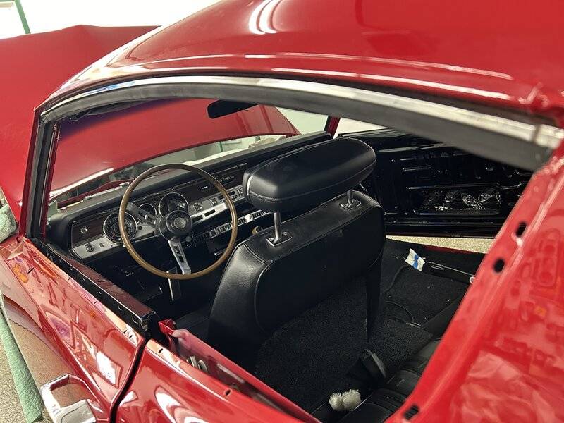

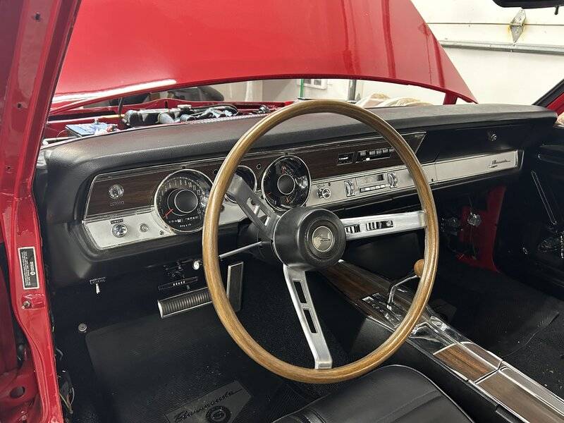

Back in the car, but would not run!! Looks like the bimetallic overload in the switch got fried due to high current when it was squealing. Fortunately I had another restored spare. Runs great. Dash all back in place and everything works ok including all the vacuum operated AC dampers.

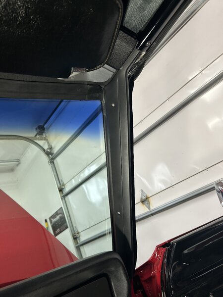

Windows installed today.
Took all afternoon! Finally found a guy who knows how to install and seal windows on these older cars. The big rear window was a real struggle to get seated in the seal. The S/S trim was a bigger struggle. Had some sections partially on but would not fully clip. Replaced several clips that were not stamped correctly. Reproduction parts- grrrr

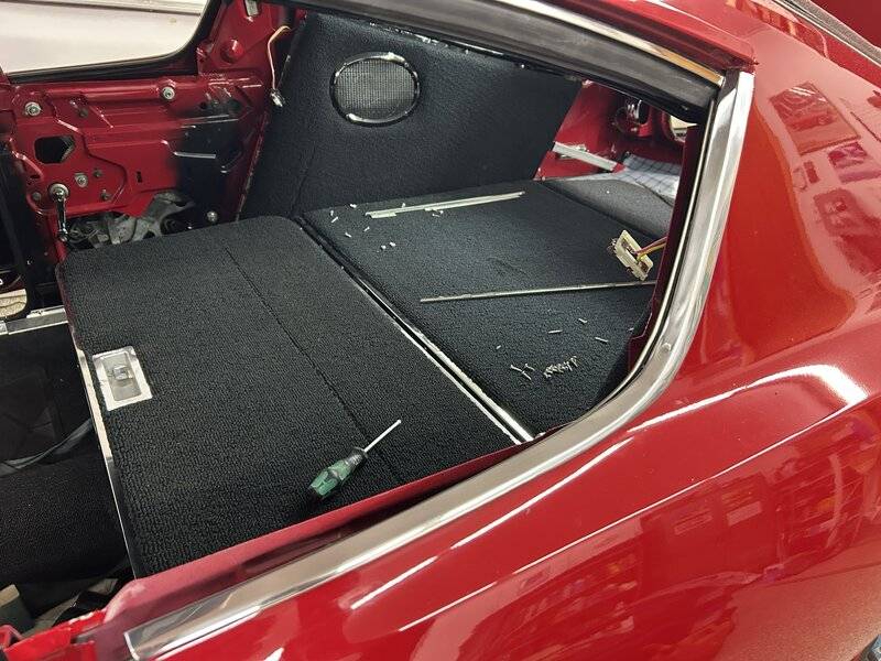

Took many hours of work just to clean and install the roof rail trim and weatherstrip!!!! The factory applied some additional white caulk to the top corner of the A pillar. One side done, now the other.

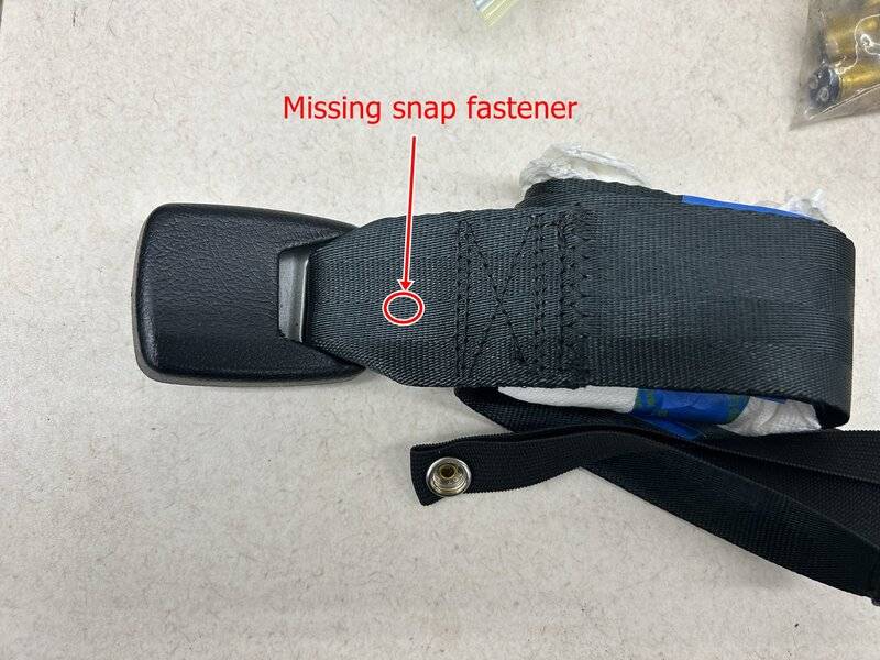

When I was installing the professionally restored shoulder belts a while ago, I found 2 problems. There was no snap fastener on the belt end and the belt was too long!!! Thankfully, I have a friend who is very good at doing upholstery work and he installed a snap fastener and also shortened the belt to that the elastic end would connect properly. Other than that, the restoration quality of all the belts was excellent.

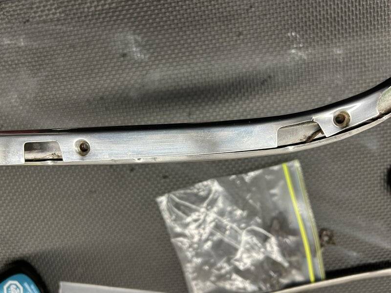

I'm installing the rear window garnish panel and am unsure if it clips over this tab or not. I did get it over that tab on the pass side, but was very difficult. I took 100's of photos during disassembly but not one in this area!!! Looking for help from someone who has installed this panel on a FB.
