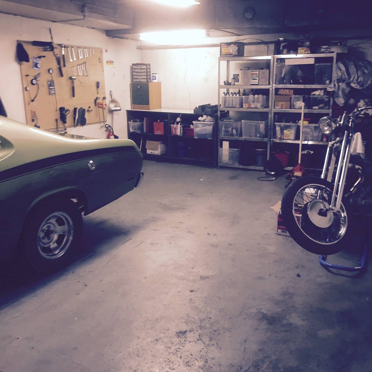

Two photos of my garage. The Triumph belongs to a friend whom I share the space with.
