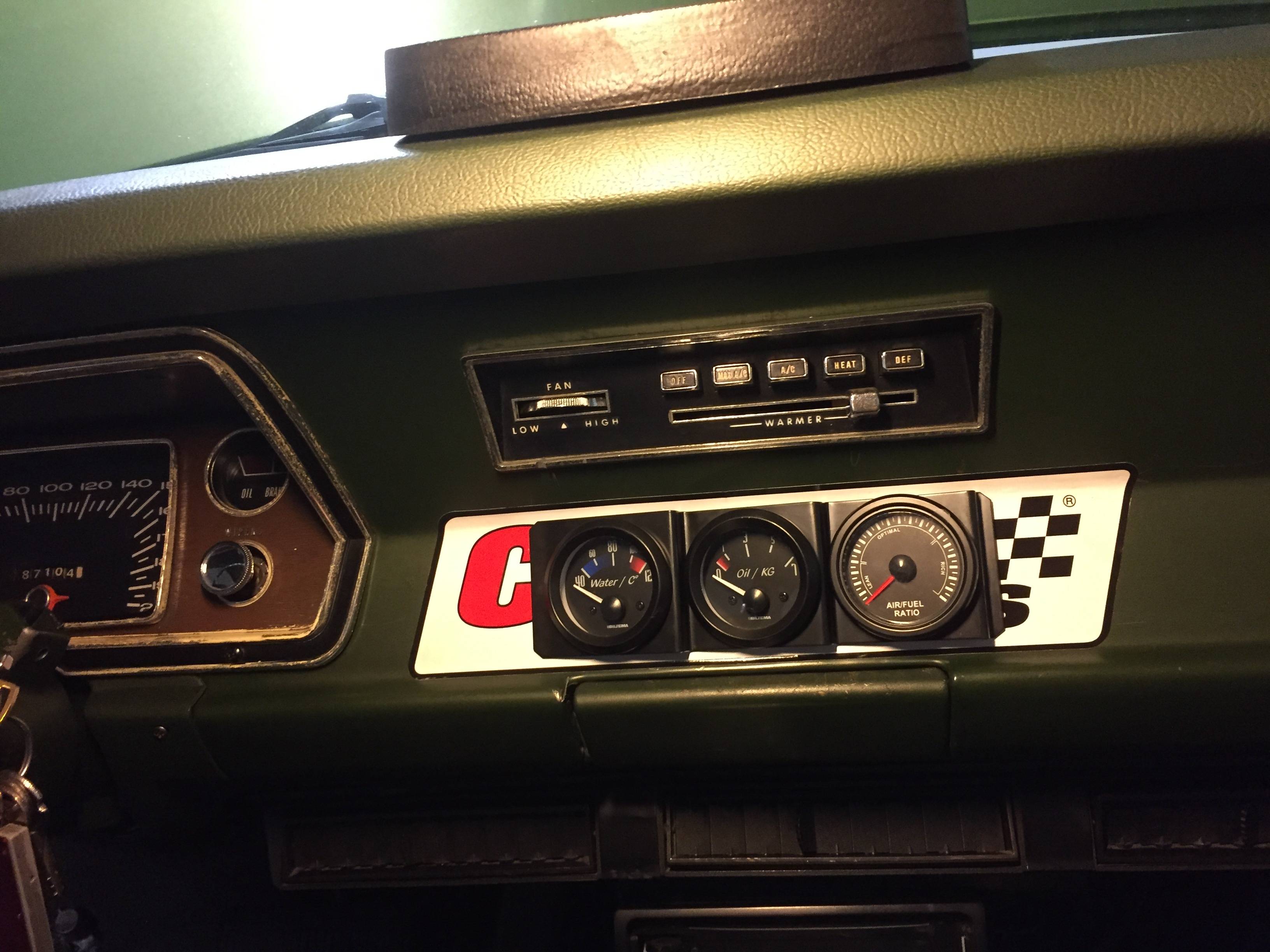

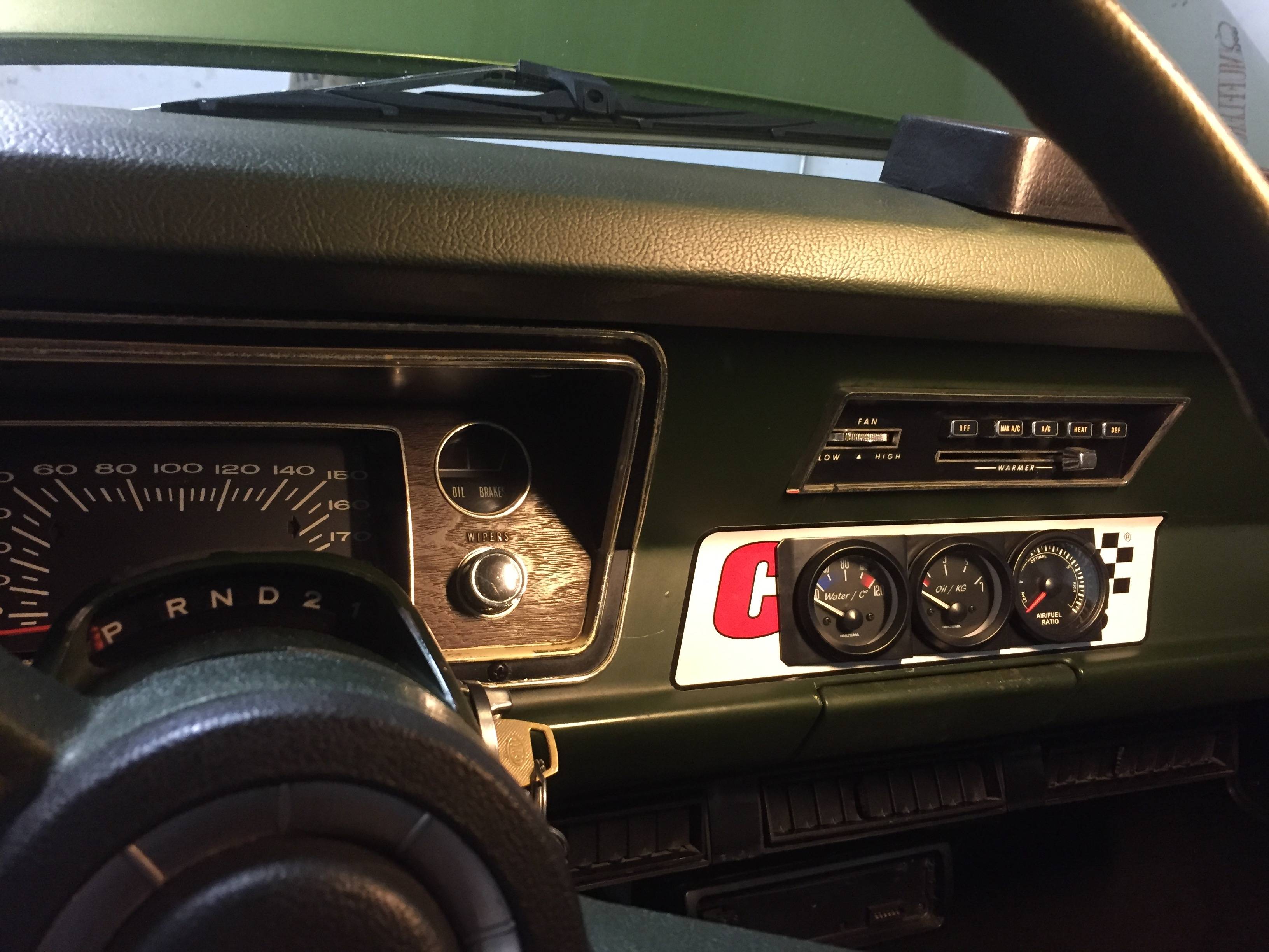

I moved my gauges up to where the old radio is supposed to be. It's long gone so why not place them there I though. The oil pressure gauge missed it's light so I took a diode and resistor from an old broken battery charger that I had in the garage. The sticker is temporary. I'm gonna make some sort of panel I can use without having to hack up the dash.
