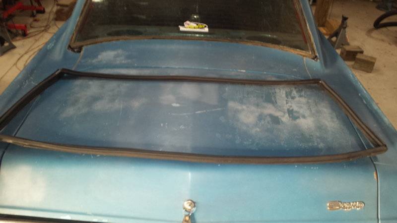

Mine look like that too. What did they put in them from the factory that makes them dry up and crack like that?
Seam sealer. Mine are cracked and showing some surface rust underneath. Little wire wheel action will fix it right up.
Does that work with the pillars as well?
You know, I've never tried. We may have to ask someone with more experience. I don't remember it being super runny, but idk........
Edit:
On further investigation the flowable self leveling seam sealers may not be that great for the more vertical areas of the gutters. Gonna consult my local paint store to get the right sealers
for the job. I like the idea of the flowable stuff for the top flat part so it can get down in all the nooks and crannies and seal it. On the A pillar the high solid stuff may be okay since the water runs right off of there.
I know RRR is using some black sealer on his but I'm not sure if it is a repair or just to keep rust out before the repairs?
