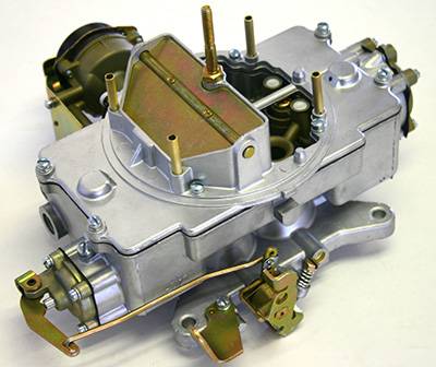

Holley used to make them. They were the 4100 series. 4110 and 4111 I believe. As I said, they were spun off the old Autolite 4100 carburetors. Summit picked them up and Holley discontinued them. I THINK Holley makes them exclusively for Summit now. Here's the Original Autolite 4100. You can see strong similarities.

They were and still are pretty darn good carburetors. As you can imagine, they are not prone to leak very easily, as the main gasket is above fuel level. The Holley 4100 series was very similar, just like the Summit series you have. It's a good design. Makes for a nice street carburetor.

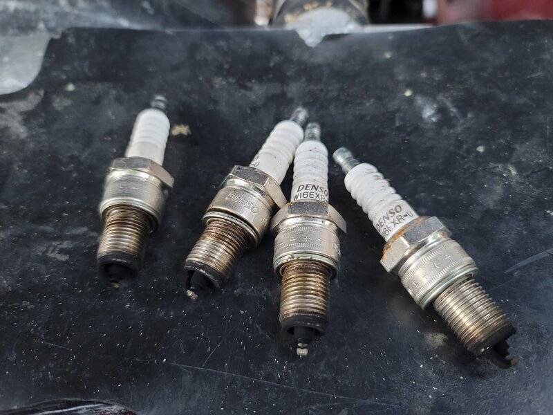

Can you please pull the spark plugs and show us what they look like?

If you look at the the centre electrode or the spark plug gap does the centre electrode look clean like the bottom photo I posted or does it look black like the rest of the plug?
Black. All 8 look the same.
Check your ignition and the voltage the alternator is putting out. When the ignition doesn't get enough voltage to fire the plug correctly it can present as an overly rich condition when in facts its just not enough ignition energy to fire the plug correctly.
I once changed the the pulley size on my alternator to stop throwing the fan belt at the top of the track and when I fired it up the tune was different and the data logger was now telling me it was rich so I pulled the plugs and yep they looked rich but I hadn't changed a jet which means the AFR didn't change but the combustion did. I checked the voltage the alternator was putting out and it had now dropped to 13.5v instead of its regular 14v + at idle.
