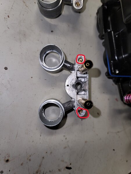

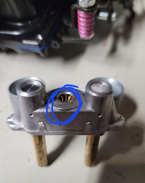

Question. Anyone know what these jets or restrictors are? Are these for the accelerator pump? They are in the primary side only.

They sure look like fuel restrictors. Have you tried calling Summit and asking who makes them? I think it might be Holley, but I really don't know. If you can get someone at Summit that will actually tell you, you could call them and maybe get more information.

Might need to do that. I'm having trouble finding info on this carb. The parts diagram didn't show them.

I believe the other bleed jets are actually the accelerator pump fuel restrictors. I'll confirm by filling the bowl on the bench and moving the throttle.

Did you read post #46. I pointed out the Idle Feed Restrictions [ idle fuel jets ]. They are a fuel jet [ not an air bleed ] because it is immersed in the fuel in the fuel bowl. As I also said earlier, the 046 could be a misprint, which is why numbered drills are reqd to properly test the orifice size.
The two jets circled in red are probably the main air bleed or idle bleed. Do you have a drawing that shows what they are? No mention of them in the spec chart in post #25. It is also possible that they are the economizer jets, which controls off idle & low speed cruise calibration. Often in the 0.042-0.060" range.

Yes, I read it. The idle fuel restrictions (The inner brass tubes) are approx. .053 based on a number drill set. The screw in air bleeds circled in the pic measure at .043. These are what I ran at .039, .043, and was going to run at .046, but never actually tried .046.
In the parts diagram for the Summit and the Holley 4010, there are no bleeds shown in the picture, which is frustrating.
