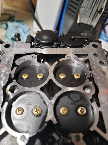

I popped the carb off and going against the directions, closed the secondary all the way. The directions say to close the screw until the butterflies are closed, then add 1/4 turn. I started the engine, now it needs the speed screw to run. But the idle mix screws can be shut and it will still run off just 1/4 of a turn on the speed screw at 750 RPM.
Looking at this pic, with the screw all the way out I feel like this is way too much transfer slot showing. I just looked at my Eddy, with the idle screw out you can't see the transfer slot in the primary at all. I wonder if this is normal. I can't see any adjustment or way to fix it. Anyone with a Holley, is it normal for Holley's to show some transfer slot when the speed screw is out??
As the beer flows through my system, I'm starting to think it's running off the transfer slot and not the idle circuit.
Ok, let’s clear up some **** before you go down a rabbit hole you don’t want to.
Unless you have way more T slot showing than what you showed, quit worrying about T slot exposure.
Just stop. If not, you’ll go bat **** crazy trying to do something that isn’t THAT critical.
How much is too much? When they aren’t working that is too much T slot exposure.
If it takes a .060 or .080 wide window who cares?
Does it idle? Good!
Do the idle mixture screws work? Yes. Then who cares?
Does it idle? Good!
Does it idle? Good!

Just redid the ignition and double checked the wires from the dizzy before splicing them to the MSD harness.
