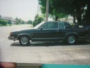

Hi Mike,the engine bay is looking all cleaned up and shiney!WooHoo!I once had a black car and swore to never again.I found it too hard to keep clean and was just to dam hot with no A/C,with hedders and dual exhaust.I,ve seen 65Varts car and the black exterior and red interior just screams OLD car too me.Now get that engine in,times a wastin!Here,s a pic of my old brand X heatbox.LOL
