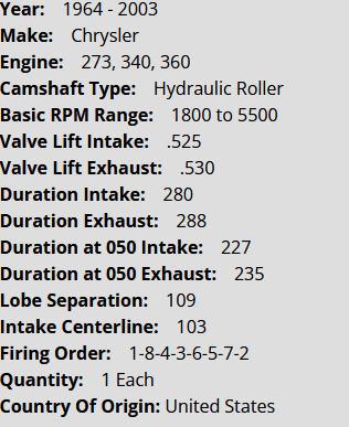

Rumble, if you see this.. Just curious if you have any thoughts on picking a cam using Vizards method? After reading/watching a ton and using his formula i should end up with a 109LSA.
Was looking at this howards cam #718005-09
If i am understanding what i was reading now, the lunati cam i was looking at i believe was 113/110 LSA and would have moved my torque up the band too much also losing cyl pressure.

thanks for any info/opinion
