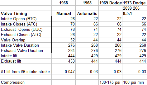

2899205 1968 Manual Transmission
2899206 1968 Automatic Transmission
2899206 1969-1974 (340 & 360 with 4bbl per 1974 Dodge FSM)
4214671 (1974- 1976 360 E58 package internet info. FWIW)
P4452782 Mopar perfomance 340 replacement cam

FWIW Here's what's in the FSM's for the 340 cams. But Wyrmrider and others have pointed out these are not SAE numbers.

2899206 1968 Auto, 1969-1975 340 & 360 with 4bbl
4214671 1974- 1976 360 E58 package quoted by @moparmandan 360 Stock Cam Spec's.?
4041998 1976-80 360 w/ 4bbl [E58 ?] in Shepard linked above.
Mopar Perfomance
P4452782 "340 replacement cam"
