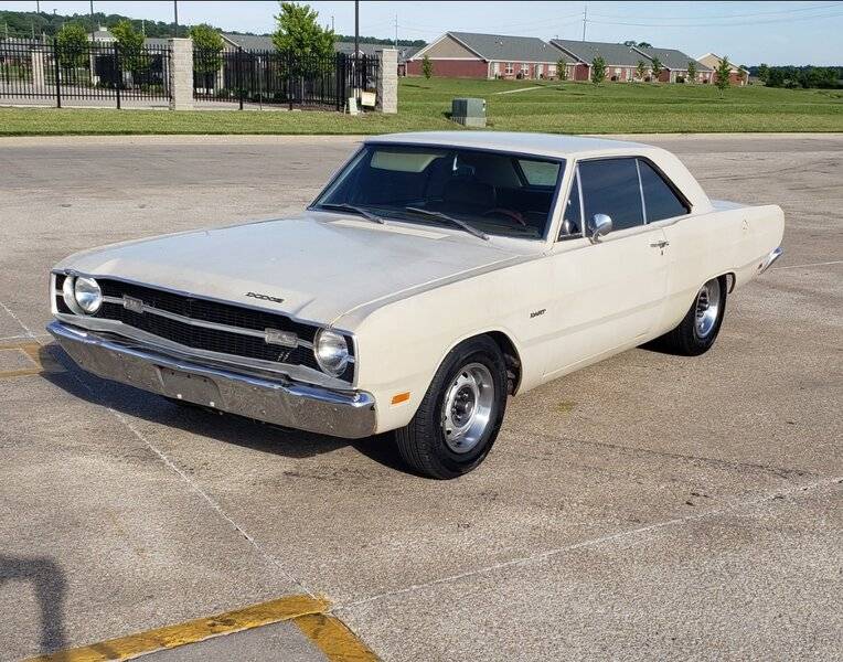

Just a daily that likes to play on occasion and something to work on in the winter on weekends.
clean sleeper ya got there.
