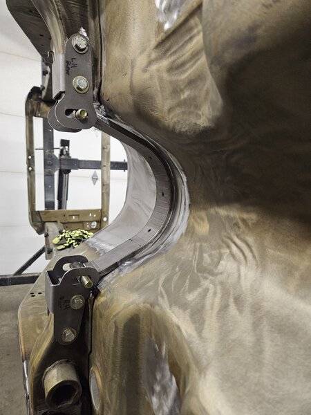

4-bar / back half the HemiDenny / HDK way
The HDK back half is complete at the fab shop so off the shell goes to my friends @ Boutwell Custom for epoxy primer and seam sealer. After that, it heads back to the (current) HDK shop for more mock up before returning back to Boutwell Custom for finish body work on the complete shell.

headed back to the HDK shop. Time to mock up and completion of the 8HP70 transmission mount / crossover support.
Maxi / mini tubs with 4-1/4 width stretch came out pretty good. Between Fog (the HDK fabricator / welder) and my friends @ Boutwell Customs....these things look almost stock...ish.

back to mock-up, making sure the big stuff still fits before moving on the the small chit
