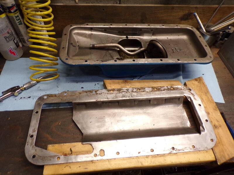

Did some rummaging around in some old piles of parts and came up with an oil pan, pick up and windage tray. Cleaned them all up and bagged them in plastic trash bags for when we assemble the engine.

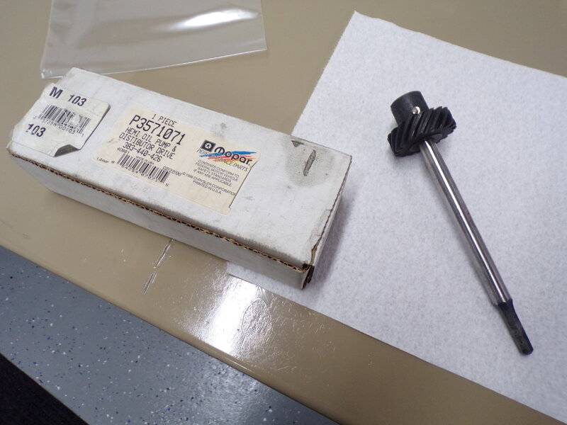

Then in a drawer in a darkened corner I found two of these. I consider them to be the best intermediate shafts for flat tappet cams in big block Chryslers

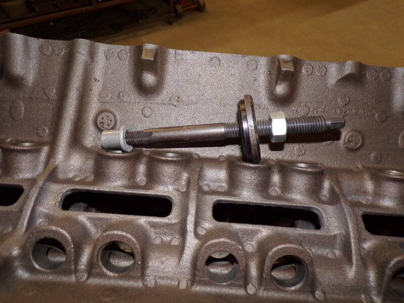

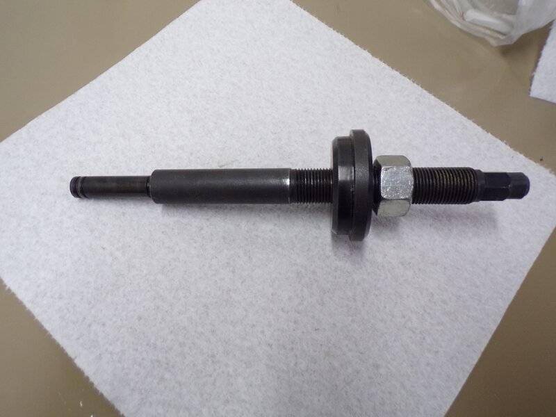

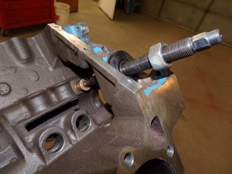

Here is the tool to remove the intermediate shaft bushing.
Bushing removed and still attached to the tool.
Bushing installation tool............
Tool is position to install bushing. Lightly tap the top of the tool with a hammer until you feel the bushing seat against the block. Don't hammer too hard after the bushing seats against the block or you will mushroom the bushing. As you drive the bushing in, there always seems to be some brass scrape off under the bushing flange. I stop about 1/16" before the bushing seats and use some air to blow away the loose brass before finishing seating the bushing. After seating, tightening the large nut on the tool draws the tool out of the bushing and burnishes the bushing to size. Then briefly I install a pump and drop the intermediate shaft into the block and make sure intermediate shaft turns freely.

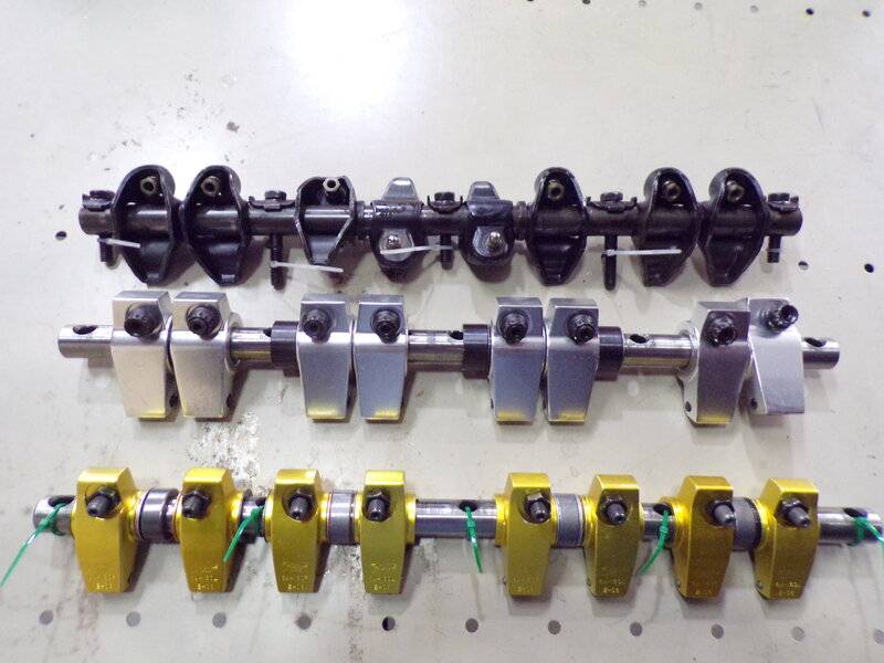

As we plan to use a solid flat tappet cam I must choose something inexpensive off the shelf around here to use for rocker arms. Decisions decisions..........Crane Gold Race, 440 Source, or these big block rockers from the late 50's or early 60's.
Who converted those OEM rocker arms? Too cool!
Boy I sure don't know. It is rumored several sets were made for some factory sponsored teams around 1960. Norm Thatcher was sponsored by the factory for land speed record attempts at Bonneville and my Dad was on the crew. I suspicion he picked them up around that time. Years back I saw a picture in an old magazine of a dragster that had a set in it.

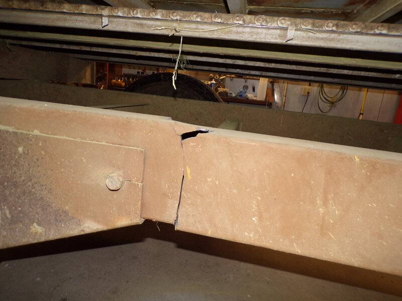

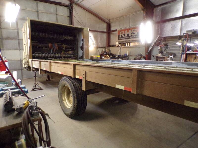

And there you have it. The main shop floor has been taken over..........
It seems the Kirby's frame is cracked and the cylinder head porter gets to fix it....................
