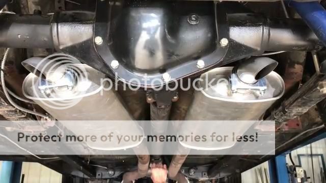

In the meantime, we are still waiting on the mandrel bent pipes to come back from the guy in TN. We have talked to him several times by phone and email and he assures us that he'll be getting our pipes out to us soon. Member VOETOM finally got frustrated and brought over a pair of Dynomax turbo mufflers and some head pipes that he just happened to have lying around. We mocked them up Saturday and we will take them up to the local muffler shop this week to get them welded on. It's not exactly what we were wanting to do, but it'll be something that I can use to drive my car this summer. We'll worry about the fancy mandrel bent custom 3" exhaust next winter.

So last night I drove 5 miles straight through the heart of town in rush hour traffic with open headers. I tried to stay off the gas as much as possible and was constantly scanning for cops but I made it okay. When I got to the muffler shop Tom was already there waiting for me. We had to wait until 5:00 when the shop closed before the owner had me pull my car in and put it on the lift.
It was a quick and painless operation. I've never had an exhaust go on so easy in my life. Pat the owner cut the head pipes down to the length we needed while Tom and I hung the mufflers. He also expanded the front pipes so that he could weld them to the header flanges that Tom had cut on the water jet at work.
The rest was just slipping pipe together and tightening clamps.
And here's the final result. Overall I'm very pleased although this is only a temporary exhaust meant to get me through the summer car show season. While we were waiting for 5:00 the guy in TN called and said that our custom bent mandrel pipes were ready to ship. Go figure.
