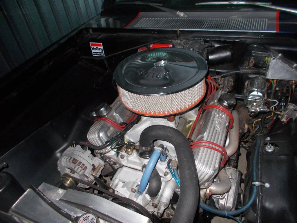

Hi so ended up going with the Doug's as I can get them locally here. What a pain installing them it's all installed now glad I had the motor pulled to fit them I havent tried putting the starter in yet. it has about 1/16th of a inch between the header tube and the power steering box. Is that normal I don' want vibrations when it' all back together running. Should I shim the motor mounts up or dent the pipe up which I don' want to do.
Solid mount the motor.
Seriously, the motor will torque to the pass side, lifter the drivers side.
I' just worried when the motor torques it might rub so that's enough clearance ?mounts are in good shape
Use a combo of thick (truck) and thin (car) isolator pads. Loosen up the stearing box and motor mounts and move everything around until you get a good fit.
I have Dougs on my 68 Fastback and they fit great!
You can get the isolators at local parts store.
Ok so I guess I'll just leave it then it' only the number 1 tube that has any clearance problem but 1 16th should be enough I hope. Had to buy a mini starter wasn' too bad with that one the old one was impossible.
