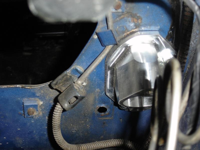

i guess i am about to shut up and wrap this thing up! lol! i worked on wrapping some things up the last couple days. got the interior back in and fired her up! i put about 120 mi on her today. damn! what a difference! nothing like rolling through the gears in a musclecar! i was waiting to put the shifter boot on until i was sure i didn't have any problems,so i will get it in and get some pics. i still have to wire in the reverse lights and hook up the neutral start switch also,but she is done. any of you guys that are following this,spend the coin for the hyd. clutch! it is worth it,sooo smooth! i hope this thread has helped SOMEBODY and thanks for waiting on me to get it done! if anybody is around nashville the last weekend of may,we will be there trying to qualify for the optima ultimate street car challenge,nasville motor speedway.

Nice work. Looks very familiar. Nicer looking hyd slave than mine.
