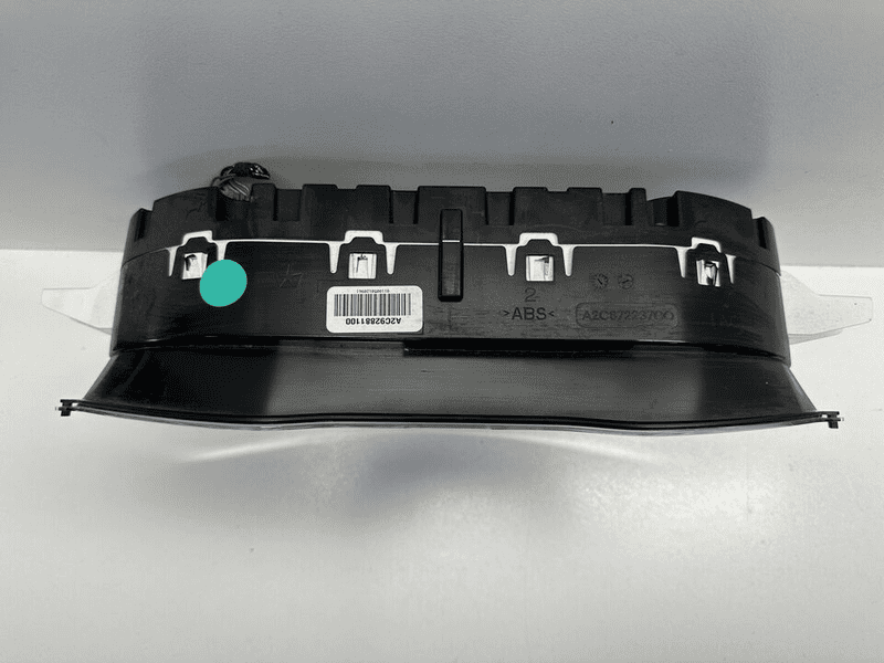

Here is one on EBay.
Here is one from a Hellcat Challenger.
For those that don't have a late model Challenger. They look like this in a Challenger Dash.
My surround for comparison. Obviously the Bezel I had to work with has some limitations for the shape.
Also having never done this, it was a learn as I go and all done just by eyeballing it.
Right, I know what they look like both in the new Challenger and separate. I just wondered what they look like without the bezel you molded in and if it could be grafted in without the raised lip. You have your bezel separated so I wonder what the IP looked like without the stock bezel.
I used disposable Cake decorating frosting bags to mix the J-B Weld in, and then extrude the mixture out through a small hole cut in the tip of the bag.
Building the layers up like a human 3D printer. :)
Unlike an actual 3D printer, I had to keep adding and sanding material multiple times...
There is a little bit of ABS sheet at the top and bottom to help bridge the gaps and then filled over and in between.

I did have to grind away some of the Challenger cluster body where the alignment pins for the lens' are on the outer upper left and right corners of the cluster.
Also had to grind away some material on the back side of the Rallye Bezel where the Cluster was a little larger than the space...
I used the cluster as my mold, applied some clear shelf contact paper (Vinyl) as my release agent and to protect the lens while working on it.

Well, so here the cluster is just held in with some tape. Was thinking about how to fasten the 2 together.
Had several thoughts about brackets, bending metal, nuts and screws, etc.
Then I kind of had an epiphany of sorts... Really very simple and using hardware I already had.
These were all I needed to attach the cluster to the bezel. Just had to drill 2 holes in the bezel webbing.
It doesn't move at all. They are become one! ;-) but easy enough to separate if needed.
The cluster is way lighter than all that pot metal that used to live on the back of a Rallye Bezel. The digital cluster is very light. I'll use the 2 bottom cluster mounting tabs to add some support directly to the Dash Frame in addition to the 8 or so bezel mounting screws. Always try to do something as good or better than factory. Shouldn't be too difficult.
