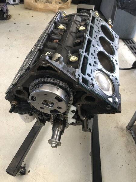

Gotcha. I only ask because I've been going in circles on lifters.
I've got a set of lifters in EngineTech boxes that have Moresa logos and p/n's on them. I found one guy claiming that Moresa was one of the manufacturer's for the OEM, but I also have several references saying that EngineTech lifters are junk and don't use them. This includes people that have had lifter failures and issues like bent pushrods with them. Not sure if EngineTech boxes several manufacturers into the same p/n and the issues were with a different manufacture than Moresa or if they had the issue with Moresa lifters.
This is what I have:
So I am trying to decide if I dump another $600 into lifters from Mopar or roll the dice and hope these are good.
Edit: I should add that all of the pictures of Mopar lifters I have found say "Made in Germany" on the box, not Mexico (Moresa is a Mexico manufacturer).

Yeah I totally understand about the lifter situation. I’m learning a lot as I go but lots of options and opinions about lifters. Watching u-tube after u-tube videos of what causes failures and what lasts longer. I just decided to run some and find out. I will report back. I’m using this engine as a learning expedition.
