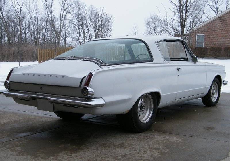

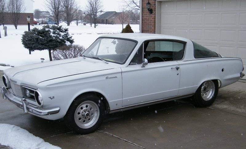

Finally I got some pictures today. I think it turned out great! I may have to raise it a bit once I install the 8 qt pan, but hopefully not.
I love the last photo with Mr. Unbreakable just hangin' out. He's like, what's takin' so long? Bring it! I've got a new cover for him, the one with the adjusters that press on the caps, but that will come later.
I liked the second photo so much that I made it my temporary avatar, until I get it finished and get a better photo.
Those are 28" X 10.5" X 15 slicks. I believe I can fit a 31" X 11.5" X 15" if I'm willing to buy 11" rims with 7.5" backspacing. I'm too cheap to buy new rims, so I'll probably just buy 31" X 11" X 15" tires and slicks since I have another set of the exact same rims with 305 X 50 X 15" BFGs on them. However, I have two pairs of the 305 X 50 X 15" tires and two pairs of 28" X 10.5" X 15 slicks so I'll probably just run them for a while.
I don't think I mentioned it before; the rear axle ratio is a 5.38 with a powerlock. I know that's a pretty tall gear, but with tall tires and the T-56 6-speed, I think I'll be fine.

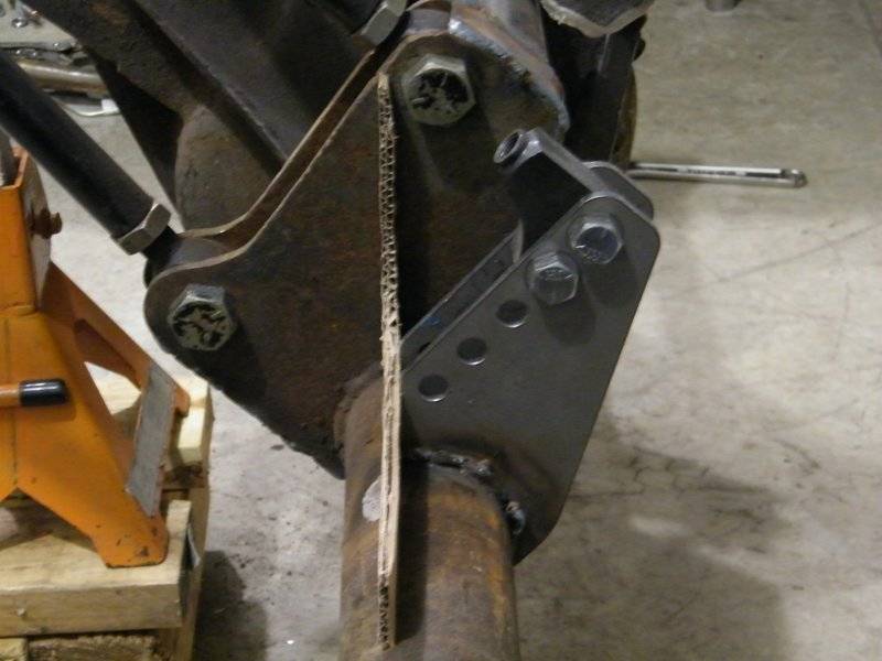

Well, last night I boxed in the ladder bar brackets on the advice of Mr. P Body from another website. His advice made a lot of sense. He also recommended that I gusset the passenger side ladder bar bracket to further prevent twisting as I intend to drive this car on the street. I've created a template of the gusset I intend to create, but so far that's all.
Here are a few pics of the template for the gusset I intend to create for the ladder bar bracket. I am attaching it to the passenger side as that is the side that will be getting side loads due to the diagonal link mounting to near that bolt. The gusset will be 1/4" plate that will be 1/2" wide against the ladder bar bracket and 1-1/2" wide against the axle housing. I will also be anchoring it to the shock bracket as I notched it for attachment of the soon to be created bracket. These first two pics are of the gusset template without the shock installed and then two more with the shock installed.
