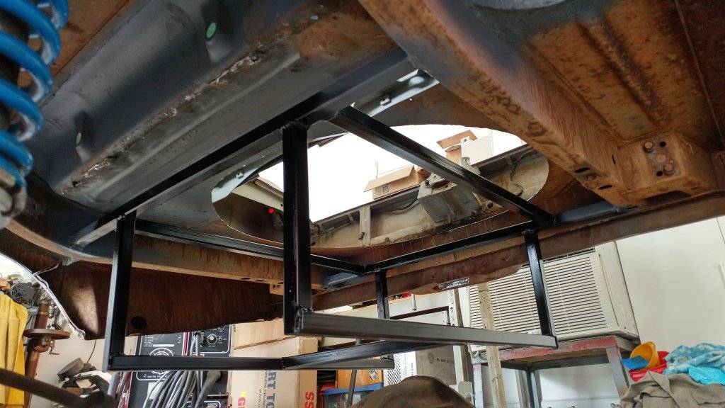

Fuel cell frame complete. Just need to prep the frame rails and get it welded to them.
Primered and painted, all but the areas that needed welded to the car, then welded it in. Already shot the welds with primer; just need to shoot some paint on the welds and it's done.
I see I never posted a photo with it installed in the frame. Here it is installed.
Moving onto T56 install. I'll worry about building a trunk pan for the cell later along with mounting straps.
