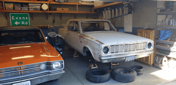

Thanks to the Toolman for linking me to this thread. I have recently started a rebuild of a 66 GT. Does anyone else here have one restored with the original QQ1 paint color. Mine was in an accident sometime in her past and repainted, the color match was horrible from what I can see and the body work they did was trash. Will post a pic of the car pre-tear down but would love to see what the color should look like.
Yours isn't all that far off. It's almost a maroon color. Look under the trunk lid, fender tag, windshield moldings, etc, to see some original paint color. My '66 rag top is that color, but, it's going to be painted bright red in the future!
I have already started A LOT!!! of tear down in the short few weeks I have had her and findidng the orig paint in places and it looks considerably lighter than the brownish maroon she looks now. Just hoping to see what it looks like fresh. The orig rag top on mine was gone but found remnants of it under the trim around the windows and it was white.
Yeah, mine had a white top too. Gonna get a black one. White looks great for a few months, then starts to look dull and shabby IMO. I guess if you're going to keep it in the garage all the time, it might last a bit longer, but, I'm going to drive mine!
Plan on driving mine also but as I got the car from my Dad, except for a few minor updates like disc breaks (hate drums) and possibly a few engine mods (within offered factory specs) he has bound me to keep her as original as possible.

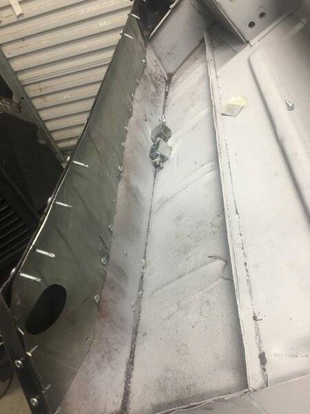

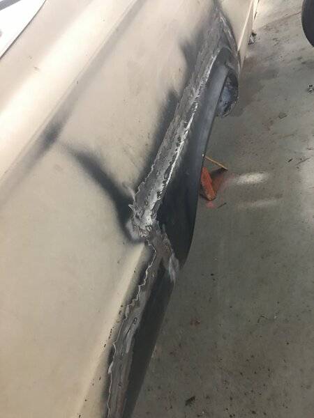

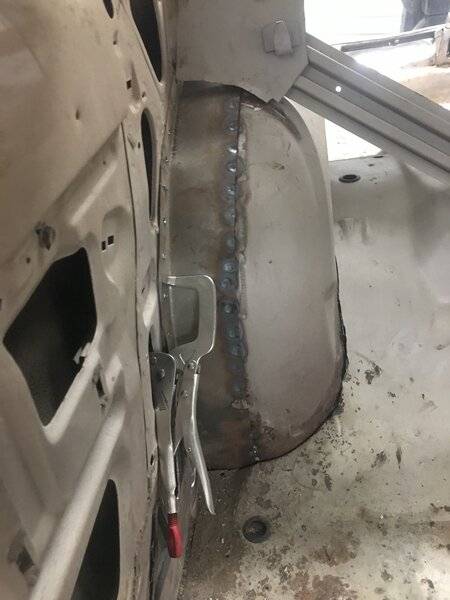

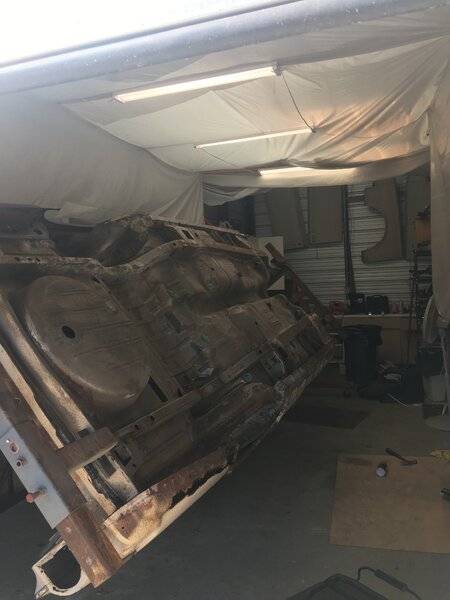

My 66 gt hard top is finley all welded up and ready for paint. When it is done it will be a DDart clone in WW1 white with no undercoating. This meant I had to do all the welds and repairs to the bottom of the car as if it was body work. The car has a Qa1 4 link on relocated perches. Uscar tool level 3 frame stiffing kit. The dart is powered by a Mopar performance 360 magnum crate engine dresses to look like a 273 commando Using the 273 timing case cover, Timing marker, valve covers and air cleaner. The car also has Fitech fuel injection with fuel injection gas tank. The car is stopped by 4 wheel willwood disk. With the mini tub the car should handle 12” tires with no problems. Enjoy the photos
Nice!!!!

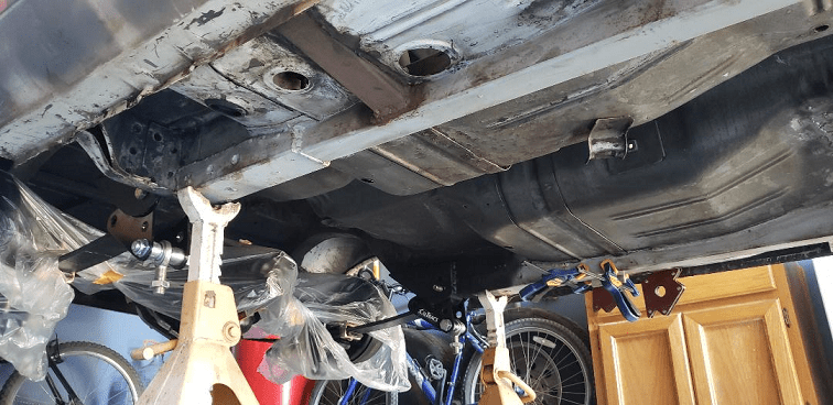

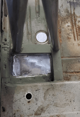

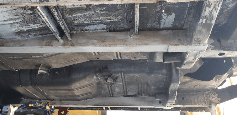

I've been getting some work done on my pile lately - suspension is done. Now I've just been cleaning up the underside so I can paint it and get the car back on the ground. I ended up scraping off 26 lbs of undercoating! Only thing left is patching the trans tunnel to make room for the 727 and scatter shield and it'll be back on the ground.
It’s looking good. I used oven cleaner to take off the under coating. I just sprayed the yellow can left it over night and pressure washed it off. It only took about an hour of actual work. It will take the paint off with the undercoating. I guess the D Dart didn’t even have seam sealer. I don’t think I want to make my tribute car that accurately. The rattling would drive you crazy!
