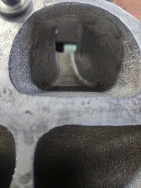

Not much to report, just did some quick rough porting on my tunnel ram runners. This ought to be interesting since there was all kinds of stuff wrong inside of the runners. The shapes were followed from what wieand cast, today I focused on taper and port shape. It should come out fairly decent. As it was the runners were 0 to -2 degrees of taper. I'm working on the lower runners in this picture.
Sorry these Pictures suck though.

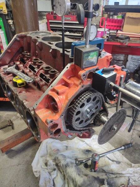

I installed and degree'd the new cam in today.
Not the 1st time I did it, last time was in highschool so I forgot.
I used a calculator to find the center of the overlap triangle close as my timing set would get is 106.5 icl.
I tried 3 different advance keyways & each one retarded the cam further.
It didn't help that I failed to do my math correctly on the 1st try. I came up with 102 when it was really 112 so, finally I said to myself retarding the crankshaft will advance the cam.
Since newbomb was probably busy, I bothered him about my findings. He told me the same thing right after I changed the timing gear the last time lol.
Checking piston to valve clearance in a day or two.

I finally got a little more time although it cost 3 hours of not working, rough porting is really close to finished, I did all 8 runners by eye for now, next step find the biggest runner and copy it.
I'm very surprised I only busted through in 1 spot lol. I have ground through just about all of weiands runner aluminum. It's getting pretty big in there.
Picture of my junky looking short block while degreeing the cam, I'm trying to get a gear drive as this chain is stretched more than I expected after 20 Dyno pulls.

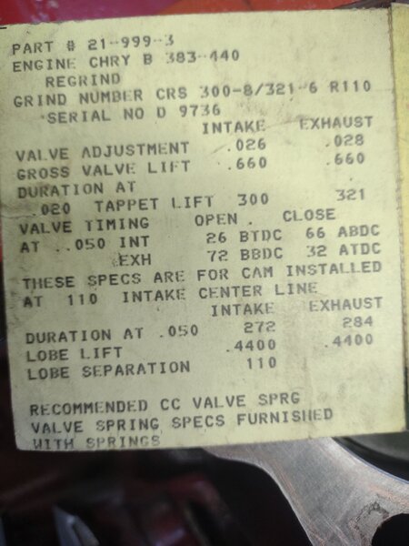

Lastly here is the cam card for the solid roller.
I run 1.6 rockers so it should be .680ish lift with lash .
Thanks for looking.
What kind of springs pressures will that have on the seat and nose?
If I remember correctly 280 on the seat and 660 open.
That's where I want it, I will have to verify still with the mic. I checked the springs already at a few different installed heights and I think it should install at 1.920 with .050 - .060 coil bind
