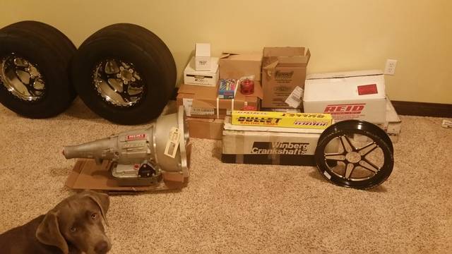

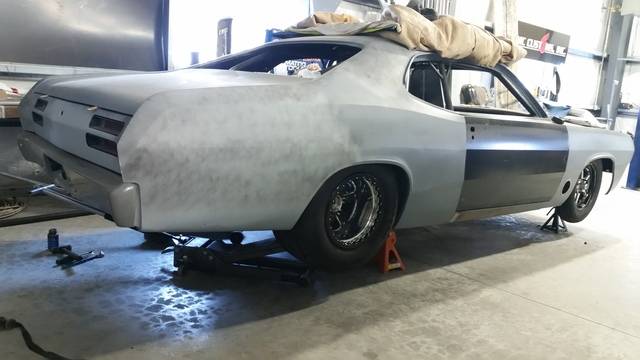

Well sorry i haven't been on in a while. I've just been busy with the new job, new puppy, new house, got married, all the things you go through in your late 20s lol
I have been making some progress on the car as I can. Here are a few pictures.
