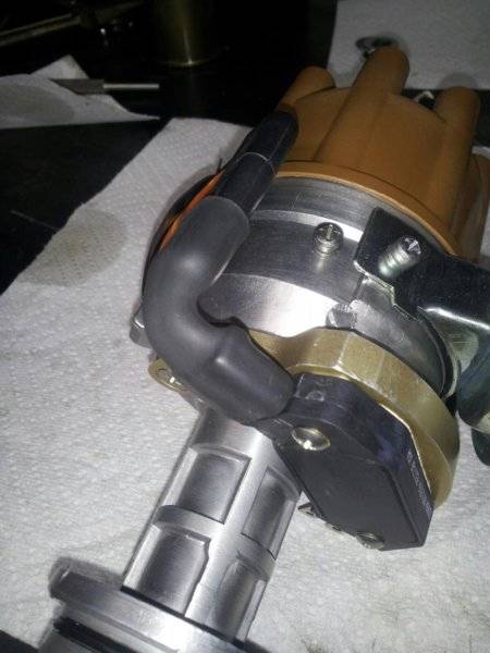

May just be a fuel related issue. However, you can soup up that stock distributor setup by ditching the ignition ballast resistor, the stock mopar electronic module and wire in a GM HEI 4 pin electronic ignition module. Use a GM E coil, or a pertronix coil with a .3 ohm primary. I used a neat adaptor bracket for the GM module that allows it to install on the mopar distributor. Gives a waaaay hotter spark. Quicker startup, better off idle and part throttle acceleration, better fuel mileage. The gold tone aluminum bracket is made by www.designed2drive.com its about $25. It threads in where the 2 existing distributor drain plug holes are. The custom adaptor plug from GM to mopar i homemade for my distributor .
I bought the same adapter for the HEI that I will use on my electronic dizzy. Nice piece!

Yep it's really well made. Its like a "Po Boy" MSD. Gonna run it in my 67, and in my sons 69. I hollowed out the ballast resistor and soldered in a jumper wire in it. This way my ballast resistor is the jumper wire while appearing stock, and if i ever decide to put it back stock i just put a real ballast back
