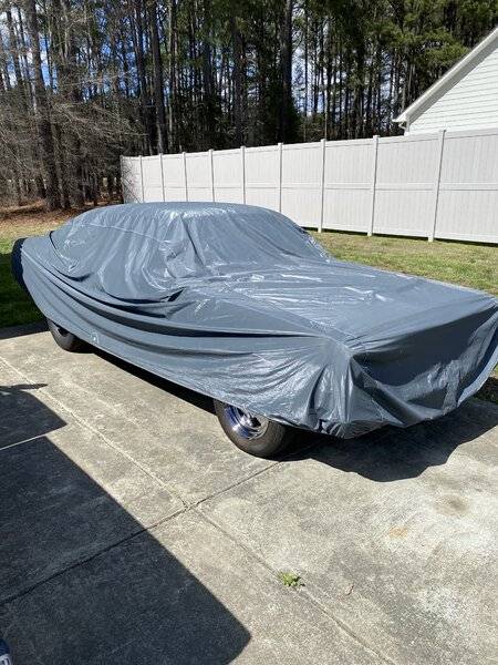

Well I’ve done nothing to the duster over the winter (worked on a dakota project) and here we are already at spring. Been wanting to get the duster cleaned and tuned up for a couple of weeks now. Had time to take it out for a nice long cruise and wash off. My cheap Bosch 044 external fuel pump decided to spring a big leak from the electrical connector after 5 yrs. Made it home without a fire luckily. Looking to change it to the Holley 340lph internal fuel pump setup. Anyone using that setup?
