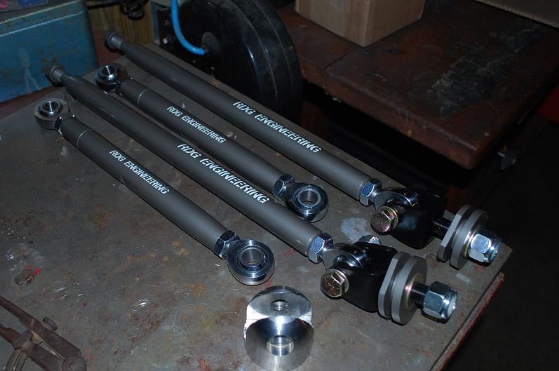

Yea, that H1DK1 Flu seems to be spreading like wildfire.. I've had it for 2 years now. In case anybody missed it, here's the suspension parts I made 3 years ago and sold.
attachment.php
And the Hotchkis parts they were loosely based off of next to them for comparison. I also made a copy of the CAP (now out of business) version for the pivot point. AAAHHHH..... the memories !!!!! Page 7, post 159 of the building case anybody wants to see more.
