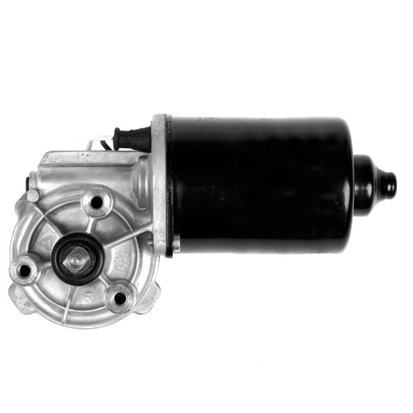

Okay after a couple Rum & Diet Cherry Coke's (great combo) yesterday I was looking at my progress so far and thinking about future endeavor's, I am going to attempt to hide the wiper motor by flattening the current firewall motor "notch" and adding a new "mini" dodge motor to the inside of the firewall, I don't thing it will be all that tough to do but since there's all these "thinking outside the box" members watching the build, I figure I would ask if anyone has done or seen this before......I know there will be some fabrication of brackets and some re-wiring but any other help or ideas would be greatly appreciated....

Seen it done and doing it myself with an LX motor. I don't have pics here but when I get home I'll see if I can hunt them up. There was a guy on BBD that did it in his Dart, you may want to do a search over there. Came out great. I just need to figure out how to wire up the delay...
Oh my goodness, I was planning to hit up the local wreckers for the same wiper motor and brackets and such. LOL, great minds think alike. I think rjste(sp?) did this in his Demon build.

I just sent rjsjea a pm asking for better pics and help ...funny you should mention that. Also I have no problem making a couple extra brackets on the waterjet. I'll keep ya posted. Although my main focus is the rear suspension right now I like to jump around while I'm waiting for parts to come in, if your cruising junk yards looking for a wiper motor I'm still looking for a Challenger fuel section like yours in case you come across one..... theres none around here, I keep checking........

Don't know if you plan to shave the firewall and put the wiper motor under the dash (sorry, don't have time to go back and look), but I found out a while ago that later FJM bodies used a plate bolted to the wiper motor that would bolt up to a minivan wiper motor (little tiny thing) and bolt to the factory opening in the firewall on an A-Body.
Hope that made sense.
The mounting plate bolted to the wiper motor on the Diplomat setup that I grabbed. Just had to dig the bolts out from under the rubber gasket they glue over the hole plate to seal it to the cowl. Don't remember how the minivan wiper motor bolted to the mounting plate, but seems like it was easier to get apart than the Diplomat one.
Just a thought.
Just a thought.
Actually on my 76' Dodge Power Wagon (thus the Avitar name origin cause it was Orange) I converted to a later model Dodge Pick-up(90's) style which also used a adapter or mounting plate to use a small wiper motor and bolted to the original holes in the firewall. I considered this option on this build but decided to go with the smooth look...I almost had a custom firewall made but decided against it ......probally would have been less work. Thanks

Actually the motor on the truck lays the wrong way to fit in the factory location on the A body, but the adapter plate bolts to the triangular bolt pattern.I dont know what motor would work, maybe the FMJ mentioned in a earlier post would, I got the adapter from the Dodge dealer for a early 90's Full size truck.
I don't have any pictures, but when I looked at it last night it look pretty much identical to the third picture Wagon posted when he started talking about wiper motors.
Never wired it up, plug is pretty different, but it still only has 4 wires like the one on my Duster right now, so I would guess it wouldn't be hard to wire.
Pretty sure I grabbed mine out of an 88 Diplomat and a 90 Caravan. Swapped the parts around it bolted into the hole fine. Wire it up and I would bet it would work fine. Never got that far on my Valiant and haven't even put any thought into doing it to the Duster (but I am now).
About the delay wipers, pretty sure the motor doesn't have anything to do with it. I've thought about grabbing a switch out of a F-Body and the plastic box controller and wiring under the dash. Don't think it would be difficult. I don't think you would even have to get into the wiring past the firewall.
