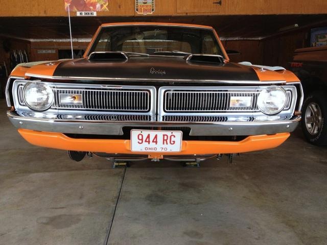

I was thinking of doing a similar thing to my 70 Dart. But the darts have a cut out area where the license plate is where I think I may be able to mount them.
The Dart bumper cut out would be pretty easy to fill in..I say go for it.
