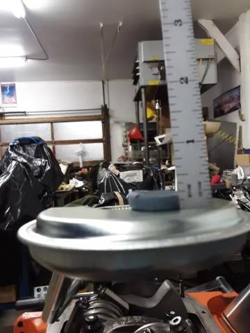

How much clearance?

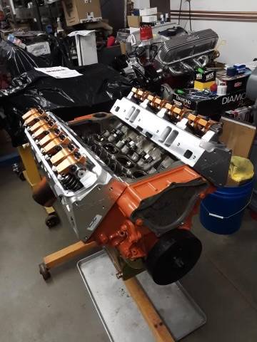

Not sure on all the specs just yet. The builder is giving me a spec card when I pick it up on Friday.

Just curious, how much clearance would you want to see?I was looking at the valve imprint and wondered how deep the pockets are and how much clay was left in between.
It’s not what I want to see but just wondered how much was left.Just curious, how much clearance would you want to see?
Good to know. I'm not sure what my builder's range of comfort is. Curious to see what the clearances are on the entire build. .120 seems tight to me but I am probably more cautious than most.... lolI may check mine up to .120 then after that it MAY give you an idea of how much bigger you could go but that cam may have a different profile.
Interesting.... I'll pull the pan when I get it home and check it again.That type of pick up (stock style) is designed to be lightly touching the bottom of the pan. You show clearance of ~1/4” and that can cause problems.
Highly highly doubt it. But I’d put it on the floor of the pan.That type of pick up (stock style) is designed to be lightly touching the bottom of the pan. You show clearance of ~1/4” and that can cause problems.
I'm seeing .180 lolInteresting.... I'll pull the pan when I get it home and check it again.

That’s why I said “can” and not “will”Highly highly doubt it. But I’d put it on the floor of the pan.

I have around.110 with my big block now, it was closer before around.100 and no issuesGood to know. I'm not sure what my builder's range of comfort is. Curious to see what the clearances are on the entire build. .120 seems tight to me but I am probably more cautious than most.... lol
And that’s why I said I highly doubt it and agreed with you on putting it on the floor.That’s why I said “can” and not “will”
