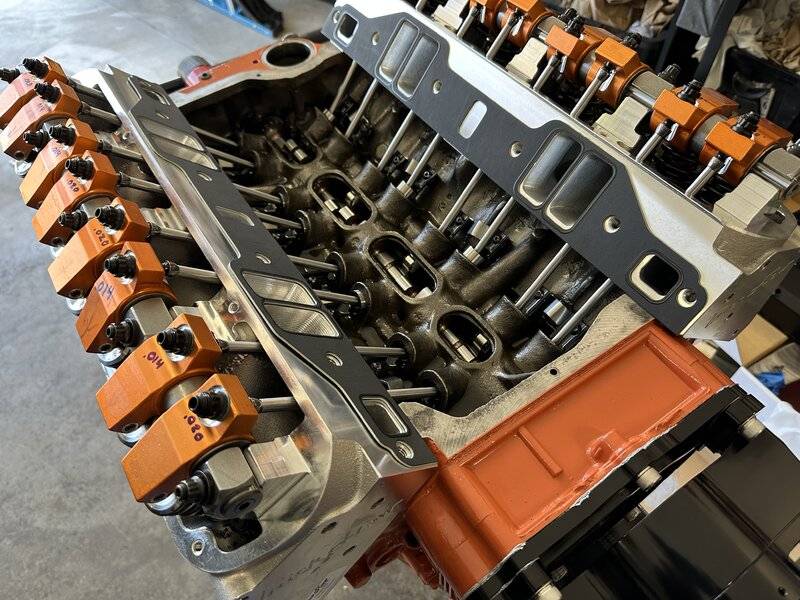

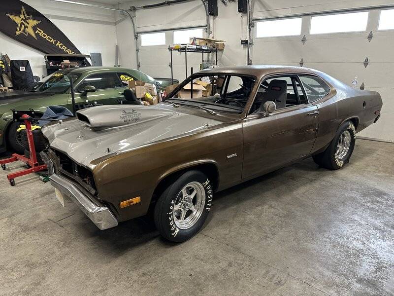

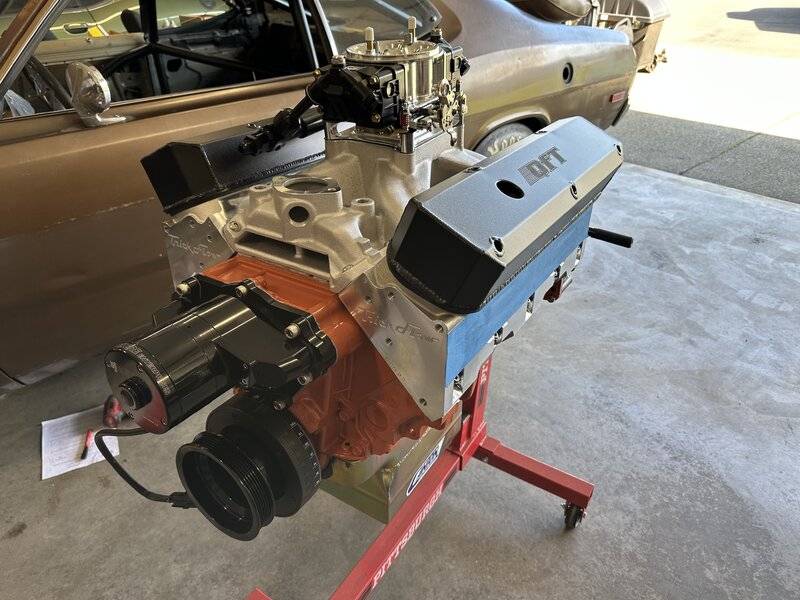

Got the engine back and in the car, decided to change the color from F4 green to billet silver so everything had to come out of the engine bay yet again. Painted and all back together, then the engine went in along with the transmission and driveline.
Of course with the color change, the interior had to all come back out and swapped for something that would go with the silver…. Good time to go full race car. lol
Is it a solid roller camshaft setup? I read through this again but did not see that, unless I missed it.

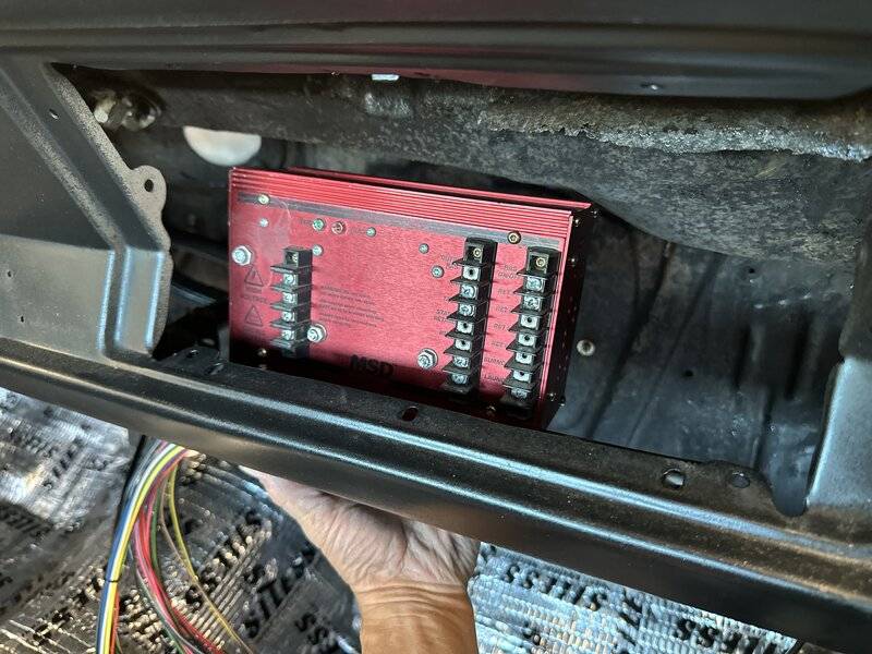

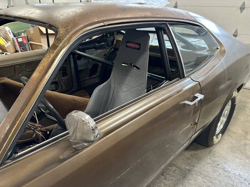

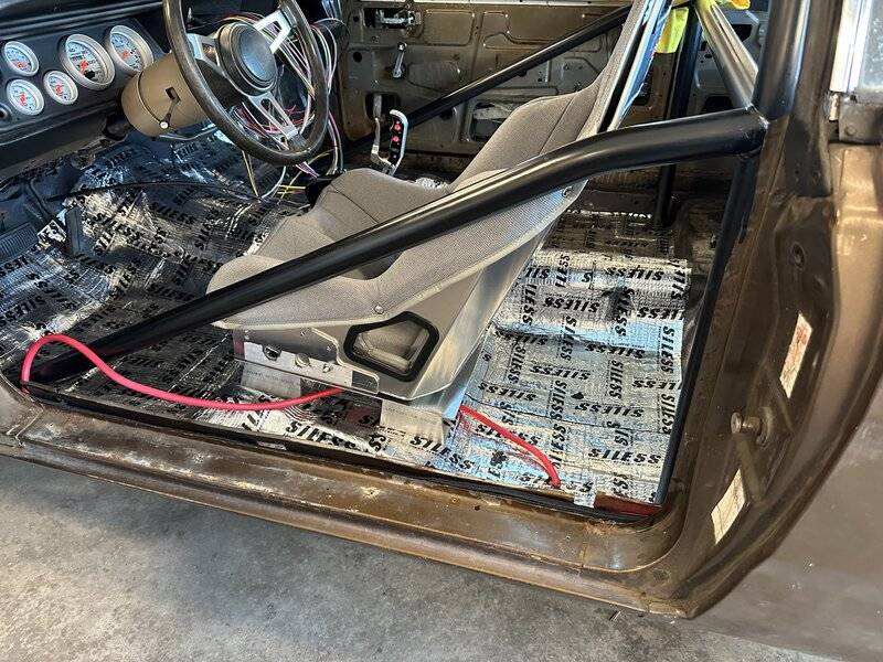

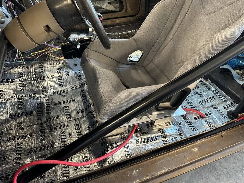

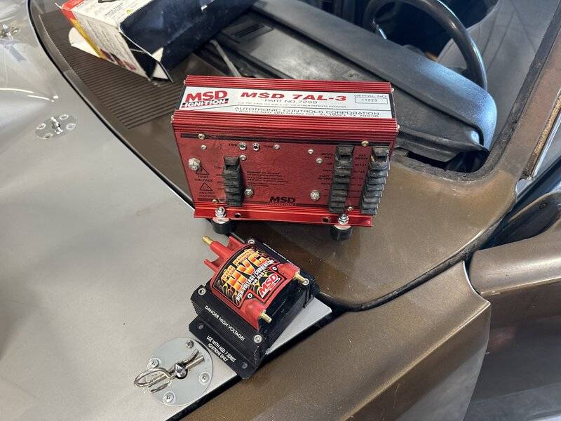

Got the seat and shifter mounted, now to mount the ignition box and coil, then start on the final piece…. Wiring.
Did you take any pictures step by step of the seat going in, what is the wide piece of aluminum directly under the seat?
It’s a plate that ties in all 4 legs that are bolted to the floor (existing bucket seat holes) and extends to the tunnel on the right side. I plan on mounting a cup holder and small 4 circuit switch panel on the right side of the seat

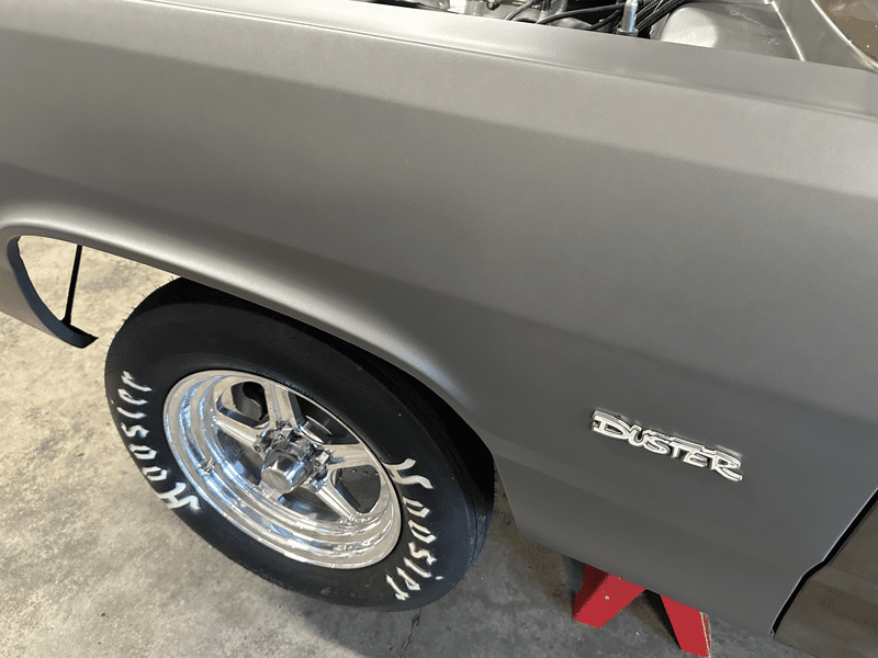

Got bored and decided to prep and paint the one body panel that doesn't need body work.... lol
The color is Matte Billet Silver
