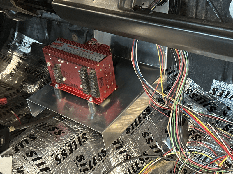

Made more progress on Fred today. Got the electronics mounted up (forgot to take a pic of the final install) and engine fired up for the first time. Crazy how it started right up and even idled on its own first try! Need to finish wiring up cooling system (fans and water pump) before I can run it longer but at least I know I am one step closer.
70 psi oil pressure is what I saw on the gauge before I shut it off.
Bill that thing sounds nasty...damn

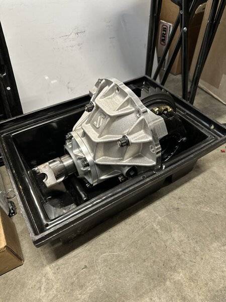

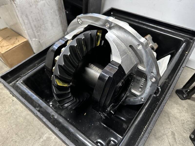

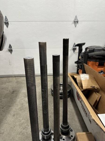

The beef showed up today so it looks like tomorrow morning it will be out with the old and in with the new. 31 spline true trac with 4.10’s getting replaced with 40 spline gun drilled axles, pro (big bearing pinion) 4.30’s spooled and 5/8” studs. Hopefully the weather will clear up in the next few days so I can take Fred for a rip.
Apparently, you mean business Bill.
By the way, holy crap there's a lot of bolts on a 9 inch ring gear
Yeah I bet. Pro-stock is GOOOOD !!!
Old pro-stock I mean
Knowing Bill it’s probably a Pro Stock rearend.
Not sure what it is to be honest. I told my gear guy that built all my diffs when I was racing offroad to build me something stout for the drag strip and this is what he came up with. He said it was a pro gear set but it can also be driven on the street We are adding a back brace to the housing and then I’m certain it will hold up to anything I can do to it.
