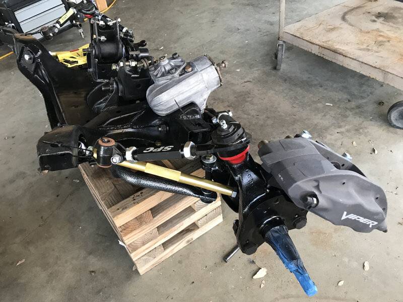

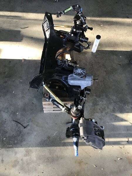

This 73+ k-frame is going in a 1969 Valiant.
Firm Feel gusset kit.
Seam welded.
Firm Feel roller idler arm kit.
LCA plates.
Bergman Autocraft Delrin bushings and pins.
QA1 strut rods.
Hellwig 5905 1-1/4" sway bar.
Not being used are my Hotchkis fast ratio pitman/idler arms ( [FOR SALE] - Fast Ratio Pitman/Idler Arm ) as they won't clear the TTi's without some surgery to one of the primaries. I am using K7075 Moog pitman. Also, I have some Proforged LBJ's, SPC (old style) UCA's, OEM spindles, Viper brake kit, & little button bump stops to put on, so stay tuned.
The QA1 torsion bar adjusters came with 4 thick washers but I couldn't figure out where they go. Anyone know?
The roller bearing idler arm takes a lot of work to do but not hard. The sway bar was a pain to install. The bars that the bushings mount to took a bit of grinding to fit on the k-frame properly and I am displeased with the bolts. It's only 1-1/4" and I couldn't find one that was 1-1/2". The 1.24" torsion bars and Hotchkis Fox shocks will make up for the .25" I think.
Coming at a later date will be a PST or Firm Feel 16:1 box to replace the core box I have on there now.

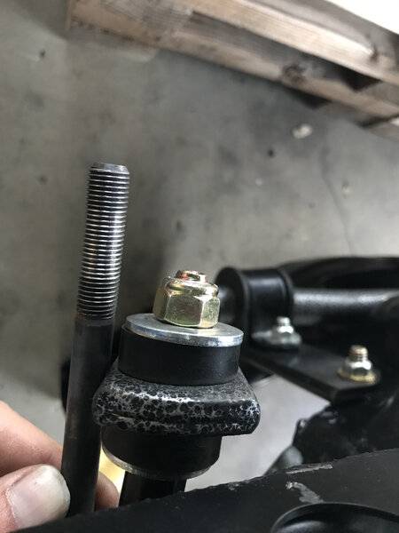

Well, I’m a dummy. After some head scratching I remembered they’re AR Engineering camber spacers. Duh. I just had them in the same little box with the t-bar adjusters.
Mancini Racing Camber Spacer Kit

View attachment 1715857437 View attachment 1715857438 View attachment 1715857440 View attachment 1715857441 View attachment 1715857442 View attachment 1715857443 View attachment 1715857444 View attachment 1715857445 View attachment 1715857446 View attachment 1715857447

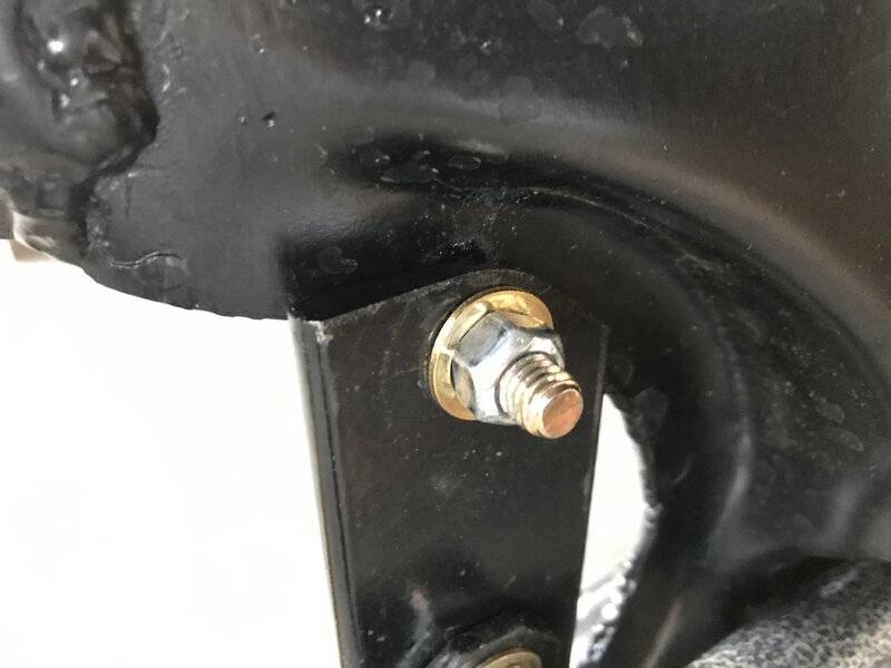

Just had to grind had to grind the plates and get new hardware. The plates were a little long. Also, the stamping of the k-member leaves a radius so I made a radius when I was grinding for fitment. The bolts were like less than grade 5. The end link bolts from Hellwig are 7” long leaving more thread than I want hanging under the lower control arm.

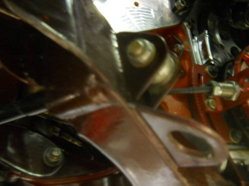

Yeah I put a radius on the ends of the plates. It would be nice if it was done by Hellwig but I wouldn't be entirely surprised if it wasn't necessary on all cars/K members. The end link bolts are also just left long, again probably a combination of allowing for tolerance and being a bit cheap on the production side of things. I ended up using shorter end links anyway when I went to the QA1 LCA's. I just ran the bolts, if I'd bought them I'd have bought better but they've worked fine.

Hey, I’ve got the Moog Camber Kit - K8243A eccentric bolts. Should I be us g regular eccentric bolts with the SPC arms?
View attachment 1715858477 Yep. The tall ones.
Nice! I have FMJ spindles so I went with Howe’s stock height upper ball joints.
Yeah I just use regular eccentric bolts on my SPC UCA’s. I set the eccentric bolts middle of range and use the SPC’s adjustment to set the alignment. Much easier to use the SPC’s for adjustment than the stock eccentrics.
That’s what I was thinking. When I bought the Camber Kit bolts and the camber washers I hadn’t purchased the SPC arms yet. I think my plan was to use an arm that had bushing like Firm Feel’s.
Agreed, just didn't know if they shaved it a hair..
I don't know either. Have to measure. Or I could dig up a OE one and see if there's any room left.
The washer diameter has to be the same for all to fit in the frame shoulders

Do you have upper control arms that are adjustable? If not I have those camber washers. You can get 2 more degrees of camber with them. I'll give them to you for half of what I paid.
