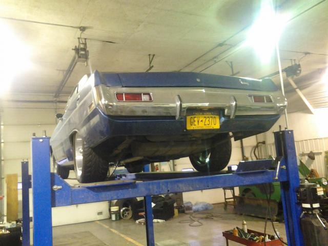

That is exactly what I did. I will check my build thread (in my signature) for tire and rim backspacing I used. I have 18x8s with 4.5" BS, you can not get any less BS or it will hit the quarter panel on mine. The tires are 255/45/18's. I can take some more pics if you would like. Look through my build you will see. I did cut the long side tube down to match the short side.

I did not roll the lip at all. I also ended up moving the rear back 1 3/8" to center the wheel in the wheel well. When I moved the rear back, the tire does get a little closer (3/8") to the quarter panel where it starts to cut back in to the lower quarter. A little rolling there will fix any potential issues.
