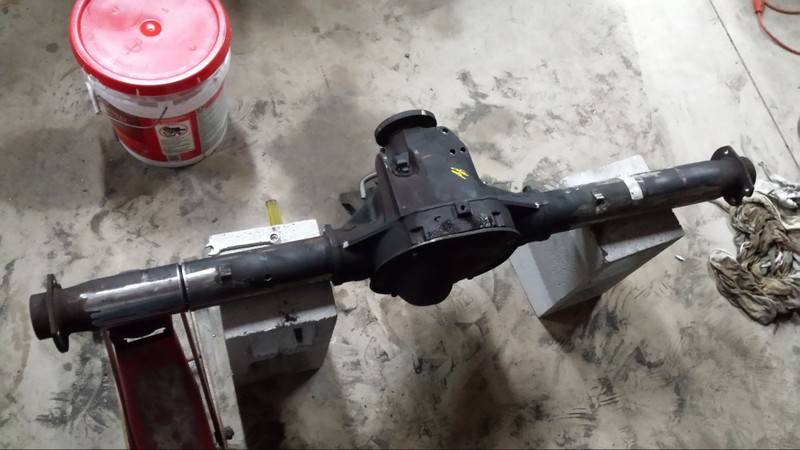

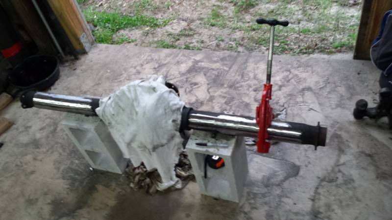

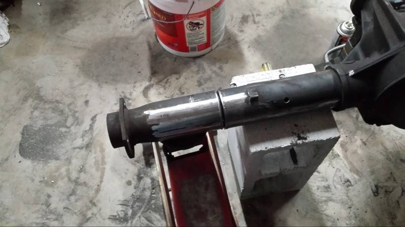

We went ahead and bought a whole extra rear end while they're still reasonably priced. 109,000 miles. For parts or what ever. We needed a short axle, u joint yoke etc. Short axles are like $72 at Summit if we ever want to run the second one. Tonight we cut!

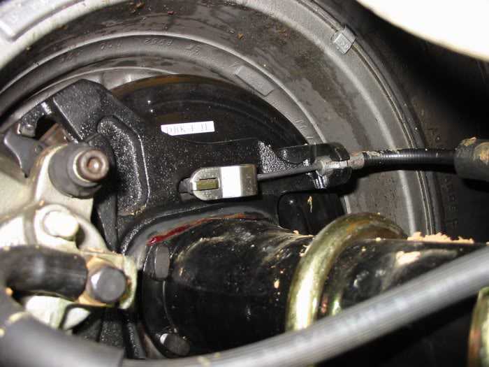

Heres a few pix of other folks ideas. I bought the rear for future use under my sons 69 cuda. Right now this car is just a pile of parts. The last pic the exploder cable ends were welded to MoPar cables.
Thanks. Unfortunately our factory parking brake cables are junk. Going the Explorer route somehow.
I will prob go pic #5 myself.. i got a buddy in aerospace that tig welds. I would have to respectfully disagree. I dont think the mopar cables are junk. They do their job just fine with a stock drum brake rear. Asking them to fit a non stock rear brake setup is a minor setback, not an issue w the stock cable.
I will prob go pic #5 myself.. i got a buddy in aerospace that tig welds. I would have to respectfully disagree. I dont think the mopar cables are junk. They do their job just fine withca atock drum brake rear. Asking them to fit a non stock rear brake setup is a minor setback, not an issue w the stock cable.
Haha I probably said that wrong. By junk I mean trashed, unusable. Rusted through. Wish I could use them. But that's an idea, maybe find some new ones?
If i go this route, I will make and add a spacer here on each side. You can buy replacement cables fairly cheap. Down here in west Texas stuff doesnt rust that bad. I bought new cables for my 67 restoration even though my originals were useable. I am using those on my sons 69 and modify them to accept the disc brake setup.
If i go this route, I will make and add a spacer here on each side. You can buy replacement cables fairly cheap. Down here in west Texas stuff doesnt rust that bad. I bought new cables for my 67 restoration even though my originals were useable. I am using those on my sons 69 and modfing them to accept the disc brake setup.
Thats my photo above. No spacer necessary. All I had to do was drill the hole a bit larger slipped right in like a champ.

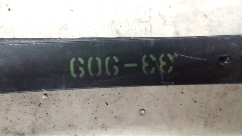

Good god the General Spring 33-909's are stiff as a cob. I might take a leaf or two out..................
Be advised the rear spring eye now uses a 1" bushing. Joe sent the right ones immediately. Price is right also.

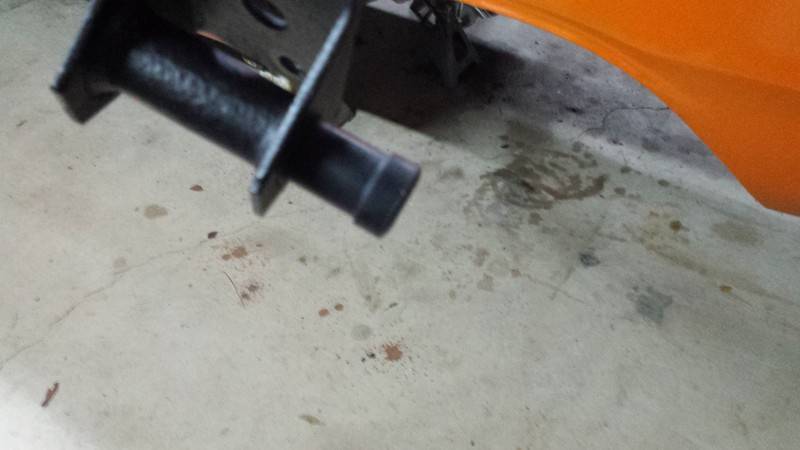

Exploder parking brake cables. This is a short side with a frame grommet/clip from the long side. Why won't this work? Or leave off the grommet/clip and after installing in the bracket, put a retaining clip or shaft collar on it? Seems easy to use two short ferd cables...........
Done. Short ferd ebrake cable fix, etc.

Not to hard to do. And the two wheel burnouts are awesome! Thanks to all who paved the way!
