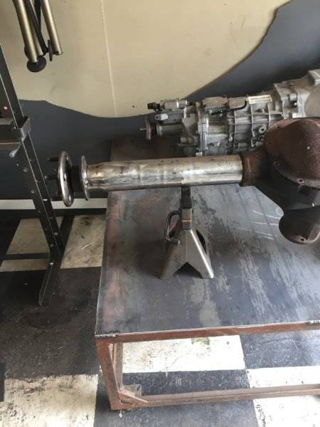

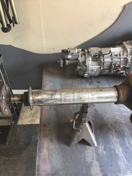

So when shortening the axle housing, so you can run the short side axle in both ends, what is the WMS once shortened?

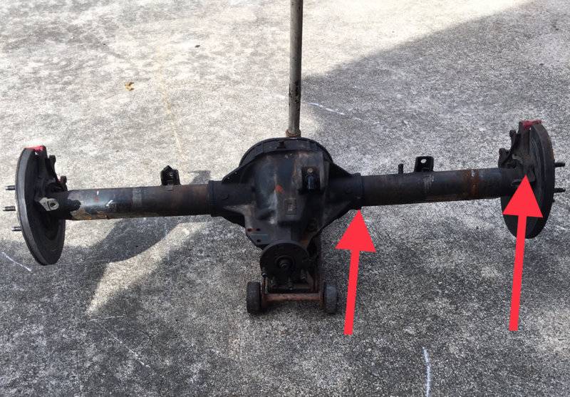

Not trying to sound uninformed since i have one of these axles and plan on shortening it. What does WMS mean, and exactly how much shorter is the short side axle from the long one ?
They don’t carry them anymore...I looked at every one I could find and even online and they said they discontinued carrying it.Anybody got a PN# for that china freight whoops i mean harbour freight tubing cutter. I searched there online it doesnt show one.
****. Oh well, i can die grinder it. I plan on having the cut where the perch can straddle it to help strengthen it.They don’t carry them anymore...I looked at every one I could find and even online and they said they discontinued carrying it.
I just measured mine like in the video I posted above and just kept checking and rechecking my measurements until I was at 2 and 7/8 before cutting it with a cutoff wheel. If you take your time it’s real easy...unlike the pipe cutting...you will have to bevel it down to where you get good penetration with your welding.

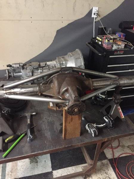

17 1/4" is that tube flange to center of the new perch, or inboard side of perch?
