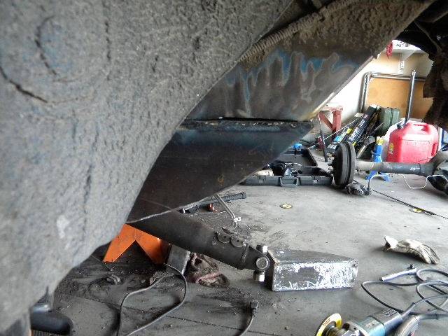

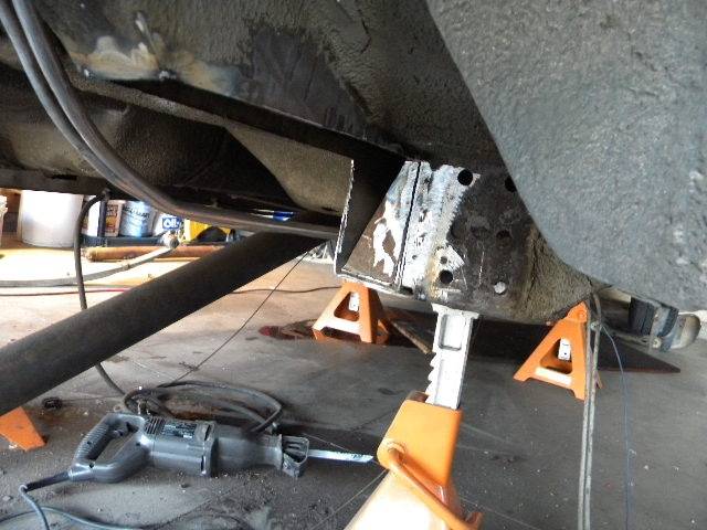

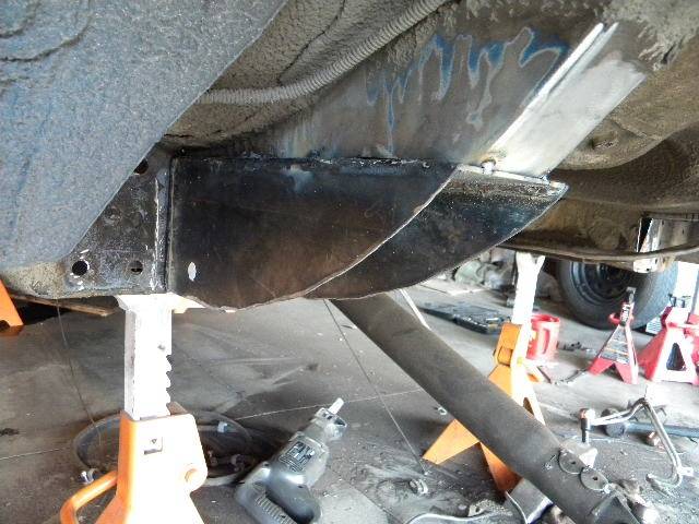

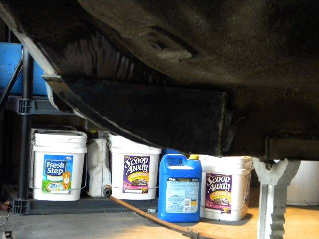

I got quite a bit done today. I finished welding up the rearend. I welded the the tubes up to the center section. I've read thats a pretty big weak spot for these rear-ends. It was kind of a ***** to weld since I couldn't really get in there and clean out all the resadue, the weld had some perosity. There's plenty of weld to hold it so I'm not to worried. I also build the relocation boxes, and cut the frame where they go. Here's a few pics.

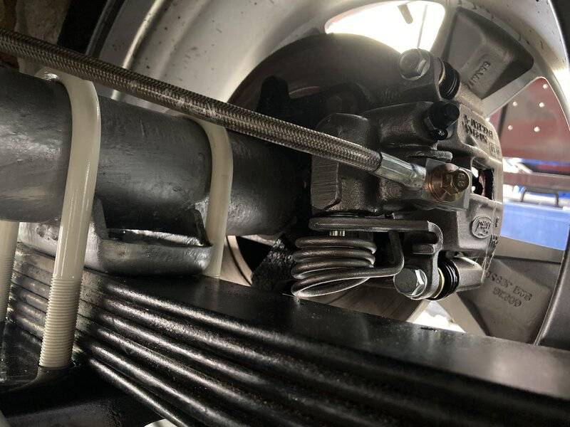

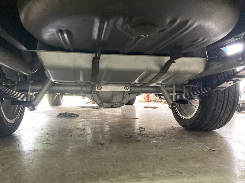

Just took the maiden voyage on my 8.8 swap. Thought I would share here because not many have used the Ranger option. I chose this option as I did not want to attempt to cut down an Explorer rear, and the Ranger is the exact width to run the Mustang Bullitt wheels that I've been running.
It cost more than most 8.8 conversions because the combination I wanted wasn't a factory option, 3.31 with limited slip.
The junkyard rear had damaged backing plates and no drum hardware, so I converted to Mustang discs using instructions from The Ranger Station
I'm running a 904 and I found a Spicer 1330 yoke and had a custom driveshaft made at 53". No need for conversion u-joints.
I used Speedway shock plates, but could have used 8.75 shock plates if I had had them. The Ranger axle is an oddball 2.75 axle tube and I had to slot the holes as the shock plate is meant for a 3" tube.
I used a Dr Diff offset hanger kit and new springs. Right now the 17x8 with 245/45r17 are about 1" from the spring, and 1.25-1.5 from the quarter lip. I have just ordered 18x9 for the rear and plan to run 275/40r18. They should JUST clear. In anything they'll just need the fender lip folded over or trimmed.
