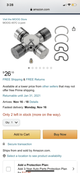

      Looking these u bolts now that have different lengths what length do I need?

      An 8.8 and a 8.25 take the same length driveshaft?

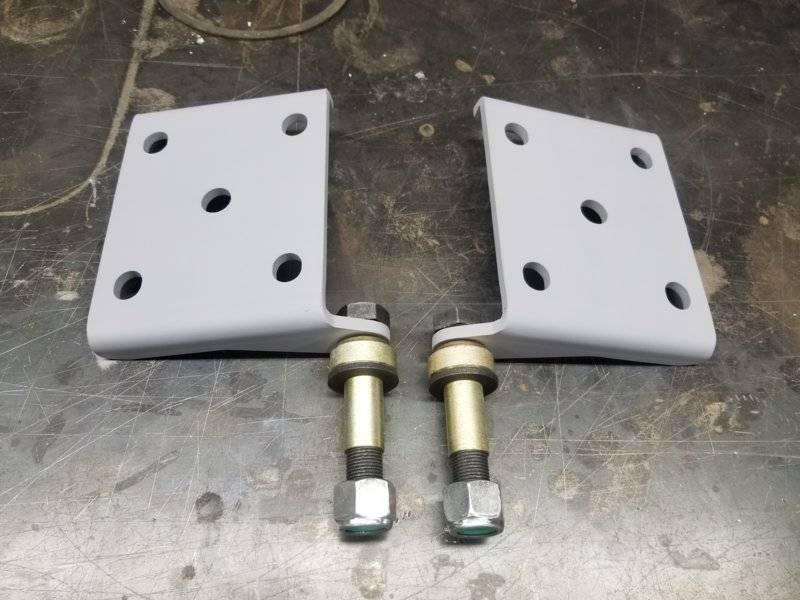

      Custom shock plates for 8.8 and 8.75 axle. I have 1 set for sale in the brakes steering suspension sale forum. Enough room for the nuts so they dont hit the end flanges

        Mine worked fine. With a 457 u joint.

          I put a 8.8 in my 87 dakota, Best I remember, the 8.8 was about 1/2 shorter.... I ended up using a new driveshaft because My trans was a little shorter as well....
          But as said, the stock driveshaft should be fine with the correct u-joint, but if you want a little longer, you may consider something like this

                              Just use the ford 8.8 bolt on yoke that mates to the pinion flange. Get a 457C universal joint that fits the ford yoke and chrysler driveshaft.
